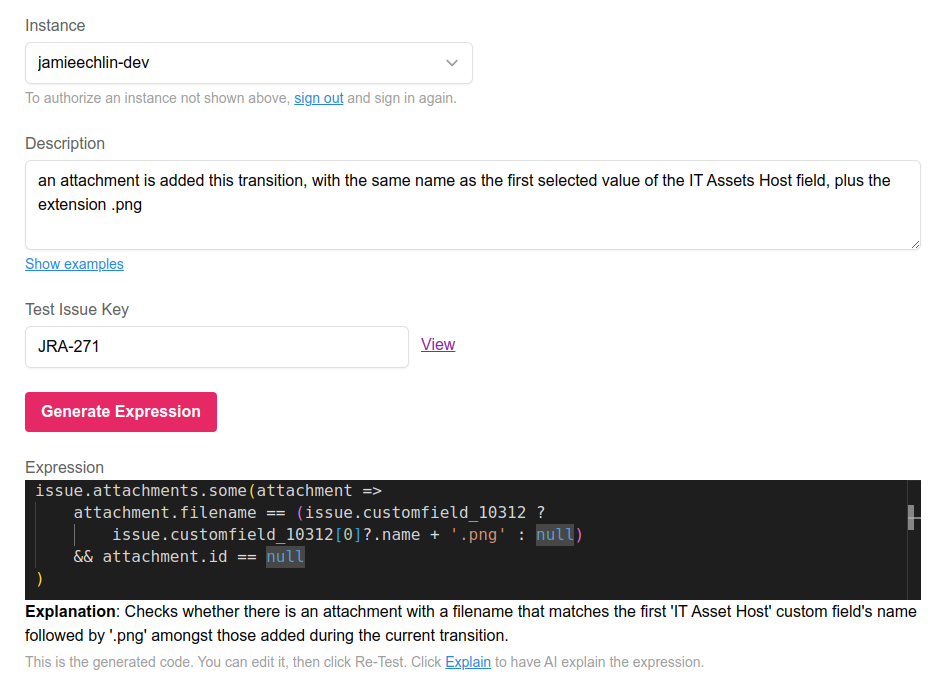

I used an in-development AI tool to give me a starter for ten on the Jira expression, which you can try yourself at https://site-8ri.pages.dev/expression .
To use the tool, first sign in to your instance, then give it a textual description of your condition. Finally, you need to give a sample issue key - it needs that to look up the names of any associated custom fields.
So my first attempt looked like:
Note - the:
 && attachment.id == null
corresponds to the requirement that the attachment be added this transition. Let's drop that aspect… it's incredibly annoying for the user if they happen to have already added the attachment before starting the transition. Not to mention it makes testing much harder.
So, this is not a terrible attempt… to be fair I haven't given the tool any training on Assets custom fields, so can't really blame it for not getting it perfect on the first go.
Doing some testing though, nothing seemed to satisfy the condition.

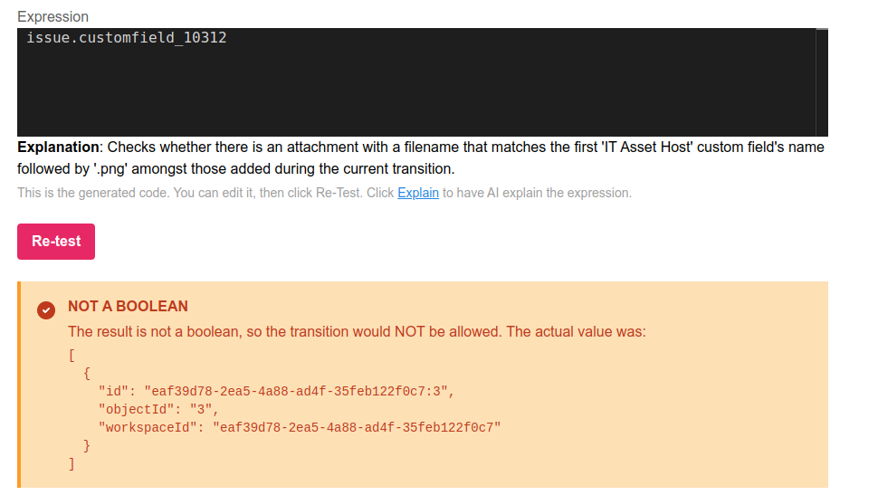

When you have problems with expressions, it's a good idea to dig into the data you are getting, that is, look at how the data is presented to the expression. To do that, we can change the condition to the following, and press the re-test button:
This is interesting - the actual issue shows the custom field like this:
1YxfOewLTnUg1lKKwzRvABCltF4RgK_emCg1MATtPBZVoqLeyzQ1O4CayDSTq2oefSB3_IlBvcHswWmlNStryi-MHST0eFopIzKChw6Pl42HqmQ_4ueTkJMc-AhLTdSMGeTSyA26zXCYnVcm-LMkzcE (682×222)
So in the expression we don't get the name ("my other host") or any other attribute. Ideally we would just be able to load the object using
new Expression(issue.customfield_10312[0].objectId)
in the same manner that you can load other data but that would be too easy. (Seriously, Atlassian could make this stuff a lot less faff).
Anyway… we can't load the asset object to get the name from an expression, nor can we use any REST API.
So we're in hacky workaround territory, might as well embrace it.
