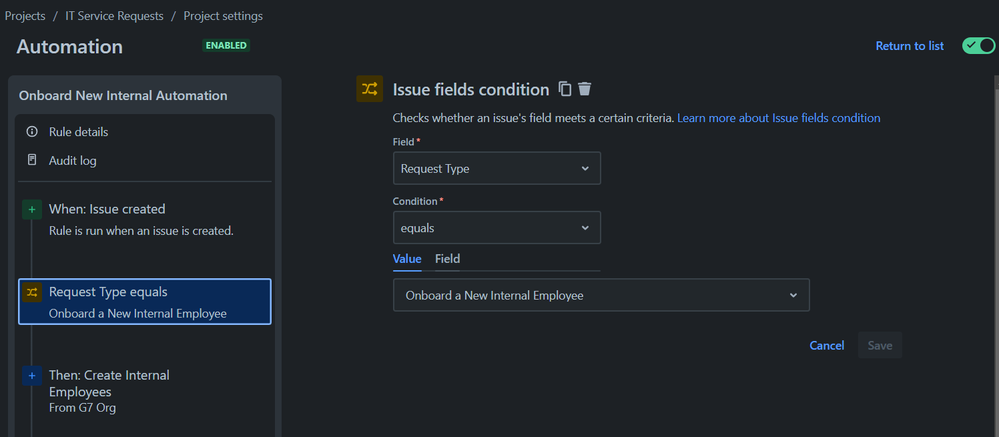

Yes I am trying to create a new asset object with automation when a request type is submitted. Trying to use the value of a custom (text) field to create the name and eventually the other attributes that are tied to that object type. I keep receiving an error in the audit log. Included screenshots for reference.
As for the cascading custom fields, I am trying to create a cascading experience from multiple asset objects custom fields. Mainly trying to understand how I can build out a request type to onboard a new employee and create objects and attached to the jira ticket all with automation.
Can you confirm if this is the correct smart value command to grab the value that is entered into my (text custom field) on my onboard new employee request type? Any help is greatly appreciated.
{{get(issue.customFieldId=10184.value)}} or {{issue.customFieldId=10184.value)}}
^I tried both and receive an error still.

You'll want something like this:
{{issue.customField_10184.value}}
