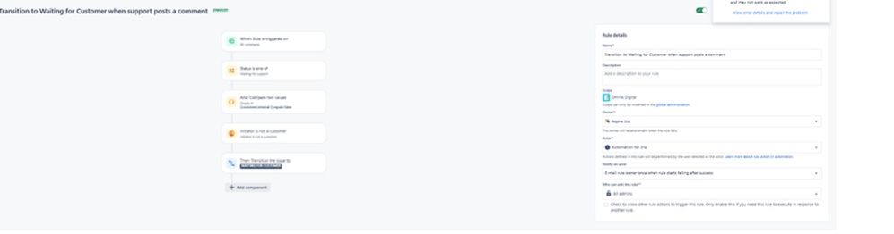

I have created an automation rule "Transition to Waiting for Customer when support posts a comment" and I have tested this by having a status = Waiting for support.
Tried to add "Reply to customer" but the status didnt change.

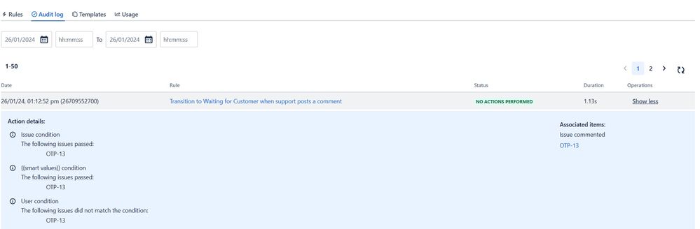

Rudy Holtkamp
January 26, 2024
So the second condition did not go through, which means that the person who triggered the automation is a customer. Maybe you put yourself in the customer section/added yourself the customer role.

Rudy Holtkamp
January 26, 2024
You should be able to make use of the template: 'When a comment is added → update the status' and remove the the else if.
But your audit log should give you some hints, why nothing happens.
Rudy Holtkamp
January 26, 2024
What does the audit log say?

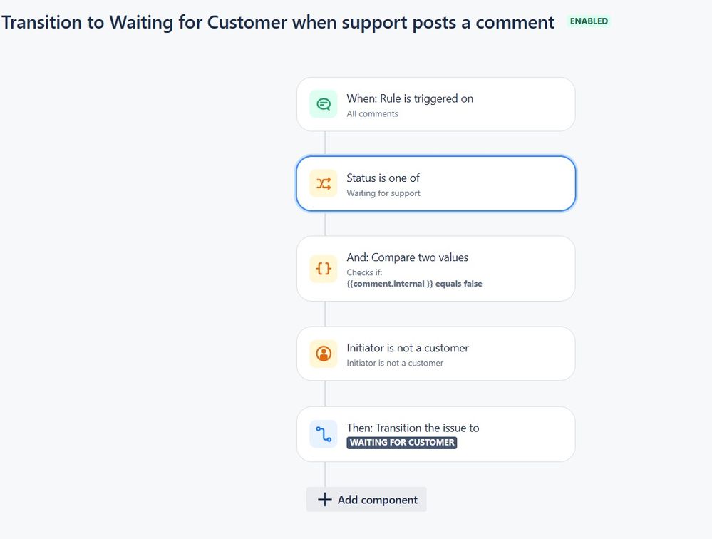

Aspire Jira
January 26, 2024

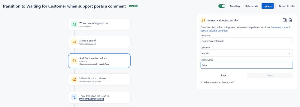

Rudy Holtkamp
January 26, 2024
Hi @Aspire Jira ,
I think you made a typo in the compare two values.
You typed: {{comment.internal }} with a space at the end. it should be {{comment.internal}}.

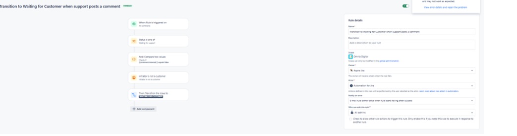

Aspire Jira
January 26, 2024
Rudy Holtkamp
January 26, 2024
Hi @Aspire Jira ,
Could you upload the picture with a better resolution, it is not readable.
Thanks
