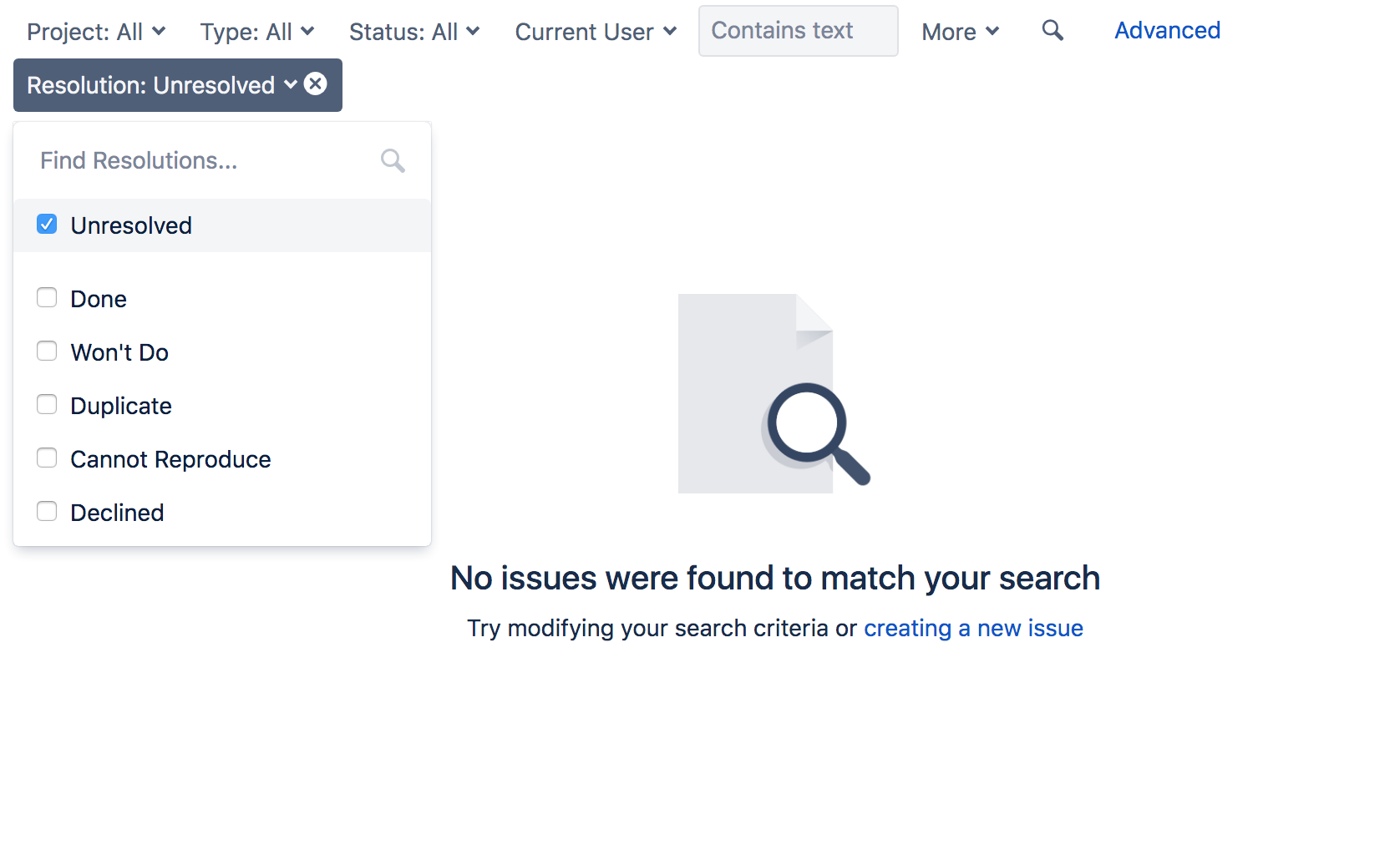

When I click on the "My Open Issues" filter, it brings up the Resolution filter as "Unresolved". However, none of the new issues I've created (all which have a blank resolution value) show up when I select "Unresolved". If I delete the Resolution value filter, all my issues show up. How can I get these blank resolution issues to correctly show up as "Unresolved"?

This is a long-shot, but could you log in as an admin, go to Admin -> Issues -> Resolutions and look at the list that is set up?
Is "Unresolved" listed there?

Are you saying that if you uncheck that checkbox in the screenshot, you see issues with blank resolutions?  Can you screenshot an example of one?
Country Sam July 22, 2019
Yes. That's exactly the case. See the screenshot below.

Seems like a bug with Jira.  Can you try adding the Resolved field as a display column and see if there's any value set there for those 3 issues?
