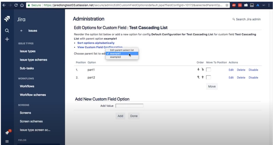

I have a need to set a cascading list of one of my custom filed.
Specifically:
CF1 has values: A and B
CF2 should be populated based on selection of value in CF1
If CF1 = A then set CF2 = 1,2,3 (where 1,2 and 3 is a list of values)
If CF1 = B then set CF2 = 3,4,5
I was planing to configure CF1 as a parent and define the list of values from CF2  (as it is in attached screens).
I DO NOT SEE AN OPTION TO SET CF is a parent.

Most of your question seems to be about how you would set up two select list fields as a cascading select.  Jira does not do this.
Have you tried using a field of type "cascading select"?  This would not need any coding or automations to behave as a cascading select.
