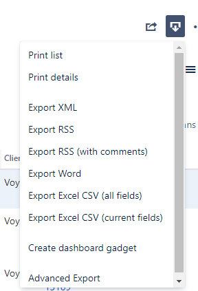

Hi John,
thanks for that. Can you advise where I can export as HTML please? I have attached a screen shot of all my export options on the cloud version we're using and that does not appear:
Many thanks,
Roy

Roy,
It seems that there is a known bug JRACLOUD-68954 : Missing export HTML option. Odd...it says the JIRA was updated in May 2019, but I don't see an update, and it is closed. It almost reads like they have removed the html option (although I still have it). There is a linked issue JRACLOUD-62115 that is open. Maybe you could comment there.
