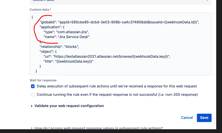

Hello @Matthias Gaiser _K15t_
thanks for your reply and I have seen that article before. On the step 3B in that article there is clearly shown that the issue link is set up in advanced mode using JSON,
and there are some data like "globalID, "Application": "Type", "name":
I assume that some similar JSON could be done for server/DC where we can specify the Server name where the issue link should be set up. Though I was not able to do it :(
Hey Yurii,
I think, these parameters should be contained in a REST API call to <JIRA_URL>/rest/applinks/1.0/listApplicationlinks.
Maybe that helps to move your forward?
