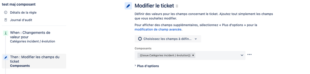

Rémy PREVOT
July 13, 2021
Hello @Dave Bosman [Realdolmen] ,
I tried it but the component isn't updated.
Whenever I change the value of my custom field, the component is not updated with the value.
Did it work for you ?
Thanks
Regards
Rémy
