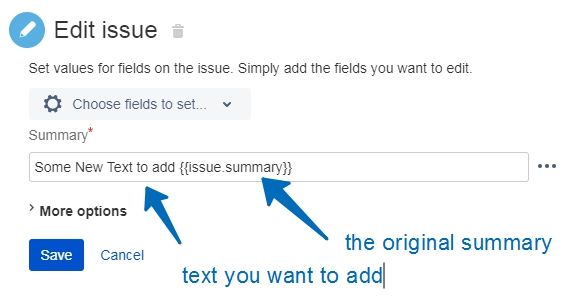

There is a way to bulk edit (replace) issues summary, I use - via Jira Automation Plugin.
you just need to make automation rule (scheduled by cron for example)
add there jql query like in jira filters, and add the action, you need to perform - edit issue (change summary),
 and then start the rule manually, or wait until it starts automatically.
Another way is to use script runner, as mentioned by Nic Brough [Adaptavist]  the idea is same.

Adding to what @Pavel Tyumenev mentioned above, we can just replace a text in Summary as below:
E.g.
Original Summary : "My Summary is - CLONE"
After Replacing: "My Summary is - SIT"
