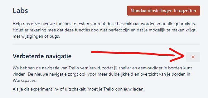

YES! I found a solution for (for now)
There is a way to revert the new sidebar thing by doing this:
https : //trello.com / {{my user name}} / labs
(replace {{my.user.name}} with your own account name, you can see that in the URL when you navigate to your "profile/settings".
Then remove the checkmark here (so it turns into a red cross):
Reload Trello and i hope you have your speed back!
(found the answer here)
