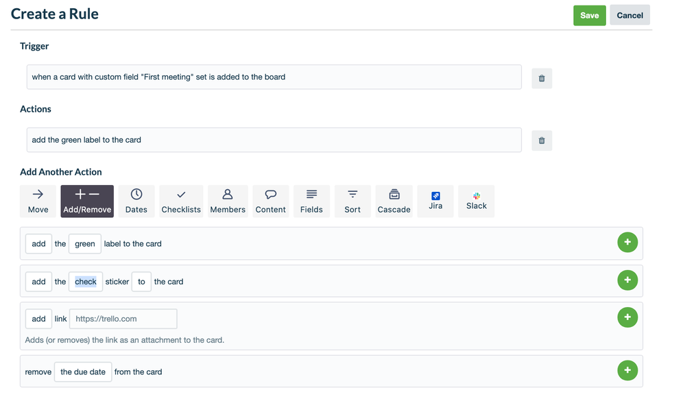

Okey dokey! This can be achieved in Butler but there are 3 rules that you need to make. I'll start from the beginning.
When you create a card and set the first meeting CF, we want to add the green label - this can't be any other kind of rule because it has to be added on creation otherwise it won't work:
Screenshot 2020-05-04 at 07.44.45.pngSo in this rule, we're saying that when the CF is filled out, it will add the green label. Meaning that you can add as many cards as you like for 'leads' and they won't count until you put the CF in.

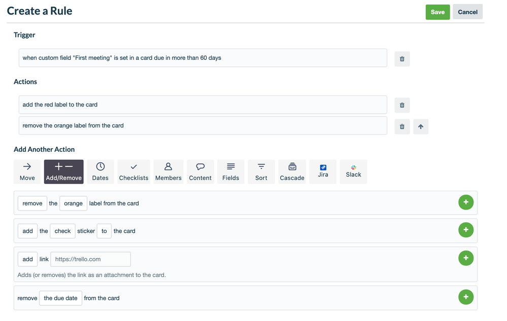

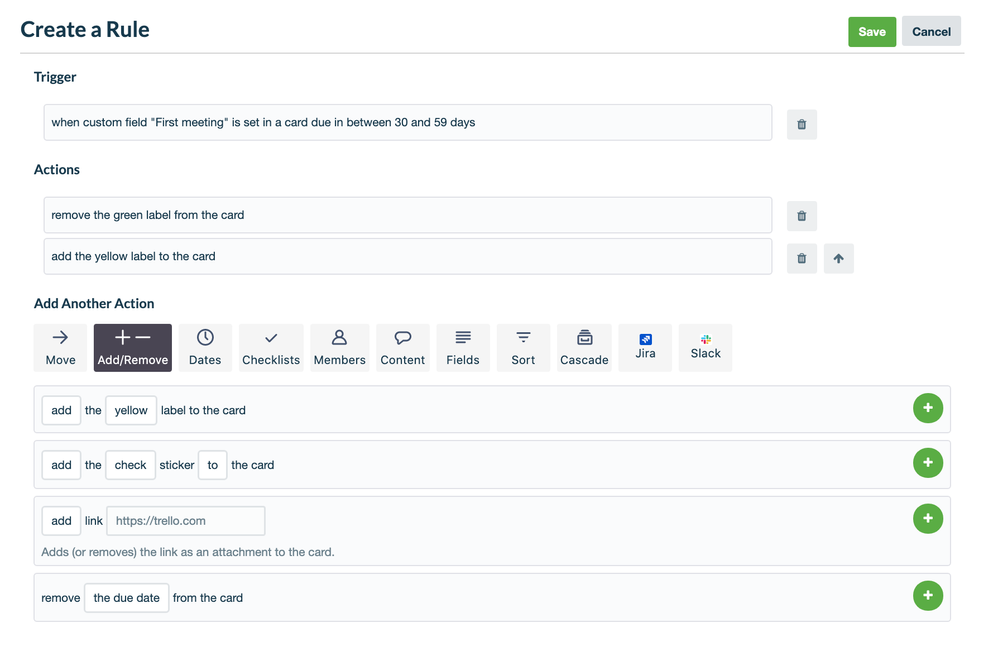

Then we want to address the yellow rule. The trigger needs to look like this:
Then you want to remove the green label and add the yellow one:
Then for the last one, the red command, you want to:Screenshot 2020-05-04 at 07.40.19.png
Then remove the yellow label and add the red:

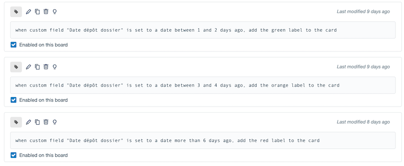

eric_bouchet
May 5, 2020
Well, well…

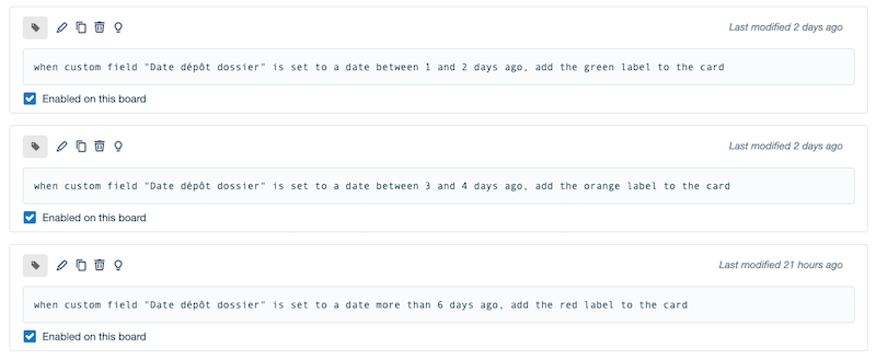

So I have set up those 3 rules to test the idea, and they do not seem to be working as expected :(

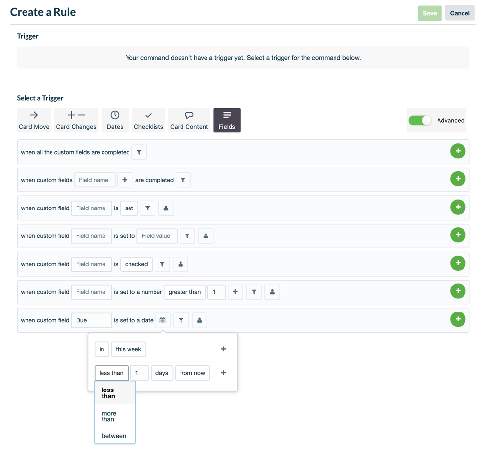

rule1.pngOn Monday May 4, I created 3 cards with different dates : May 2, 3 and 4, to rapidly see different labels colors.
It seems it picked Green correctly, as it happened at the creation of the card, but Orange and Red do not seem to come.
I am unclear if rules are supposed to run in the background, like "always", since in this case the Trigger is just a time event, so it has to check all time until the condition is met.
Any further idea ? I was thinking of using a Calendar-based Butler to move cards to a temp list to change the label color, and then move them back to their original list, but not even sure I could keep track of the original list… Just an idea to overcome some of the (perceived) limitations.
Thanks in advance

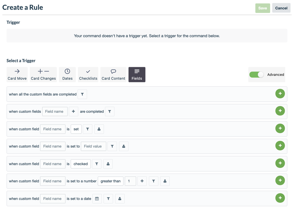

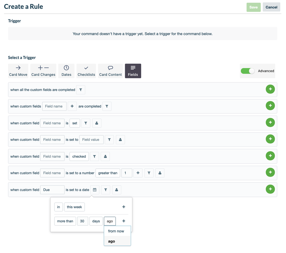

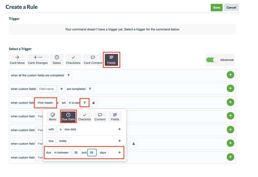

Hey @eric_bouchet

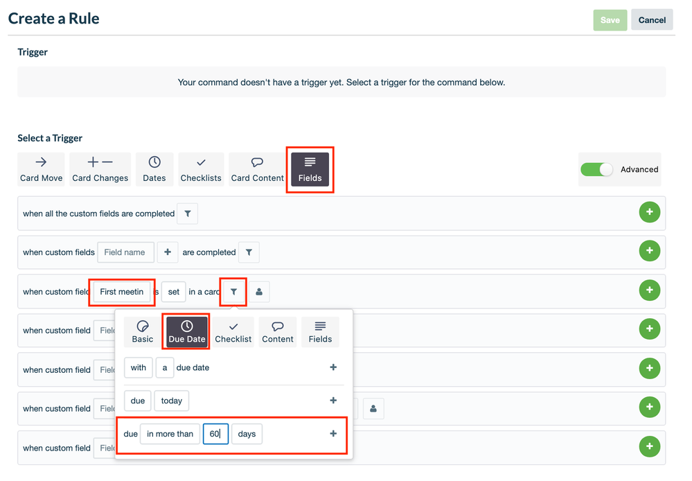

I think I might have found the rule:
Screenshot 2020-05-13 at 12.52.35.pngScreenshot 2020-05-13 at 12.52.44.pngScreenshot 2020-05-13 at 12.52.50.pngScreenshot 2020-05-13 at 12.53.17.png
Does this look like it'll work?
Obviously you'd then need to add the actions of remove the green label and add the orange, but in theory, this should work. You could have another for 60 days to remove the orange and add the red.
Let me know if that looks like a win, if not, we'll try something else! We'll get this if it kills us (although not really!)!
Esme :)

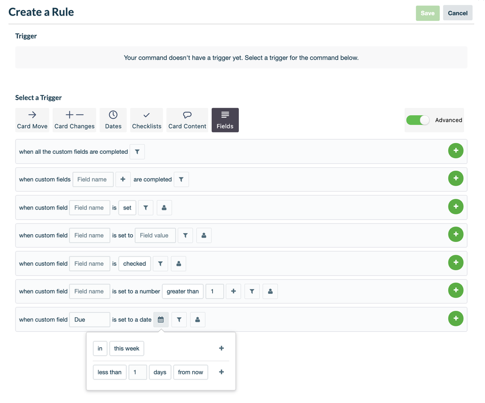

Hello @Esme Crutchley YES this is exactly my issue : I am looking for a way for these changes to happen automatically, and you confirm my fear : Butler rules only execute on a change. So this will not work with rules.
And I could not find a calendar automation that would look at custom fields :(
I understand one workaround would be to copy this date onto the Due Date, and then apply Butler Due Date logic to perform my label change, right ? I'd need to check with my client whether we can use the Due Date field for that matter.
