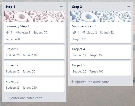

I'm trying to setup an automatic summary for lists with card count and few custom field summing-up without success yet ;-)
Attached is my optimal result with of course automatic update of the top summary cards when project cards are moved out/in of lists or if custom fields values are changed. Another key thing for me is to get summary and project info in the same screen.capture 000125.jpg

I checked Card Size PU, it's great and might be useful but doesn't really fit my needs as I need counting and summing up on specific custom fields filled up by other automatic processes.

I may have missed something but for my use case, Butler can trigger a rule on moving a card to a list, then search for a summary card and set custom fields of this card but with limited action, such as set value to x or increase/decrease by 1 or x with no ability to use variable as x. So to me summing-up is not possible.

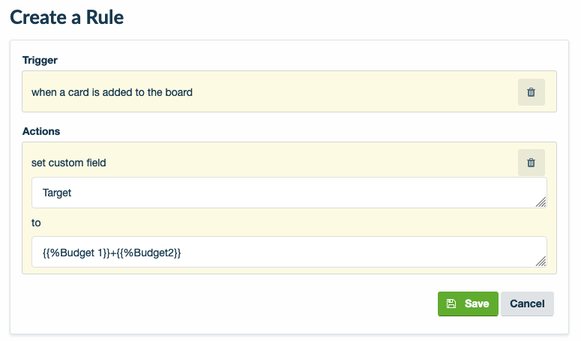

as long as I don't see your use case, I cannot say it's not possible. But doing arithmetic with custom field variables has been a possibility in Butler for a long time.
Below is a simple example that illustrates how it works:
Here is the support documentation (not very much, but better than nothing) that explains the concept.
Does that help?

I need to do arithmetic like : when a card A is moved to list step 1, then search for a card named summary in list step 1, and set custom field of card summary to {Budget of summary card} + {Budget of card A} OR increase custom field of card summary by {Budget of card A}
