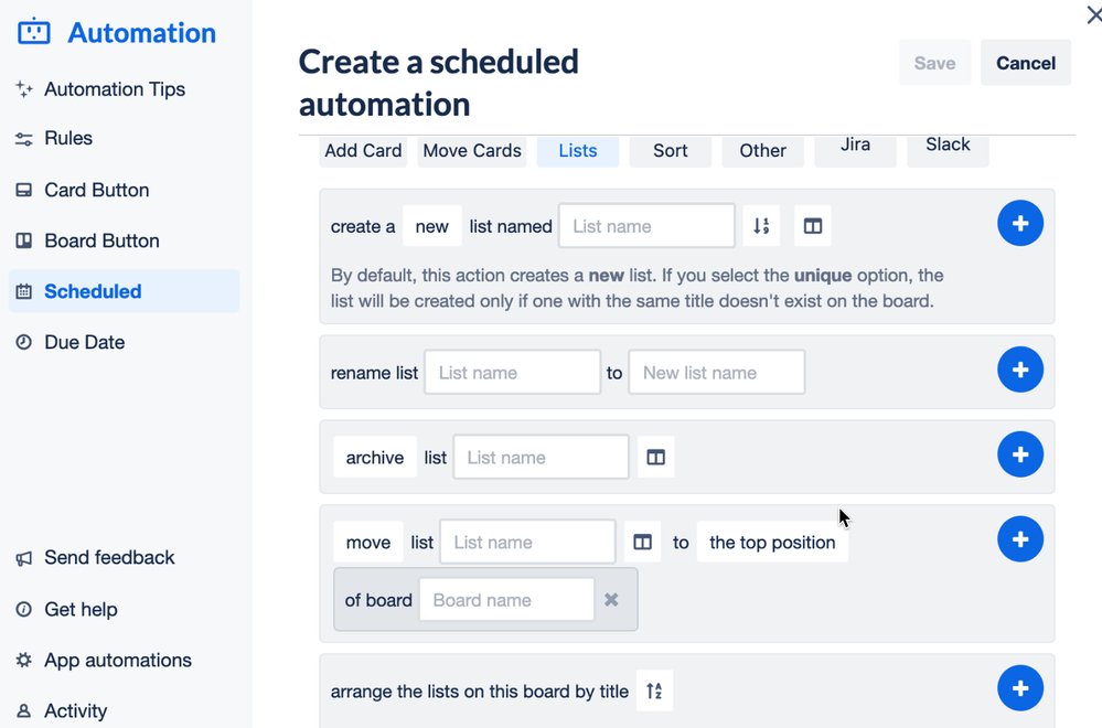

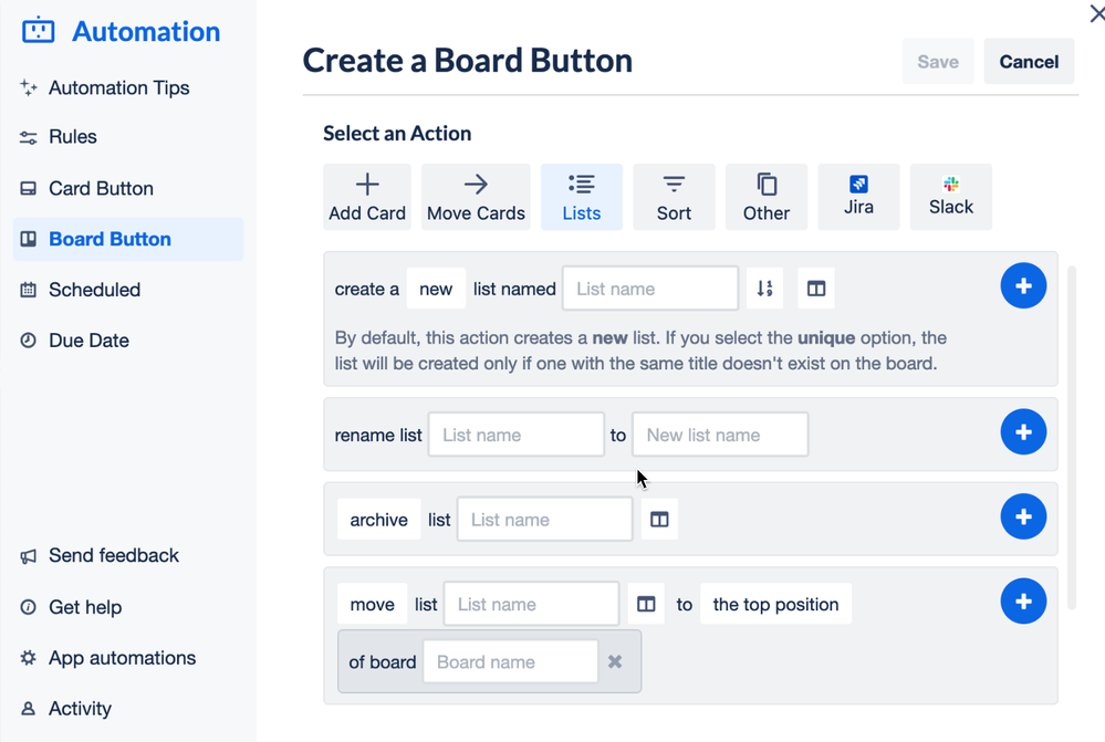

I tested and I was able to create board buttons and also scheduled automation to move lists with the cards on them, here are the actions you'd need to use:
Screenshot 2023-06-07 at 12.57.23 PM.pngScreenshot 2023-06-07 at 12.57.29 PM.png
Any doubts let me know.

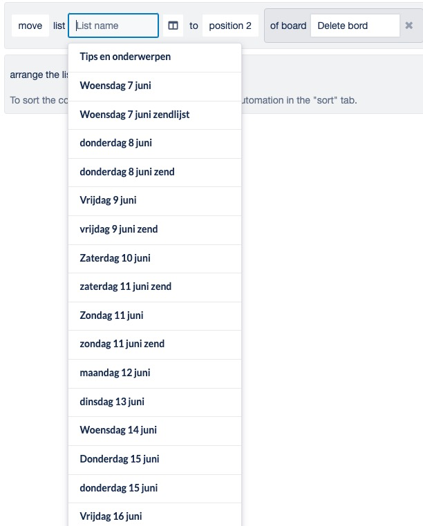

PeterD
June 7, 2023
For all of these actions, I have to explicitly name in the automation the list in that should be moved.
These list names are all dynamic, so that would not work.
The automation would only work for one list at one time.

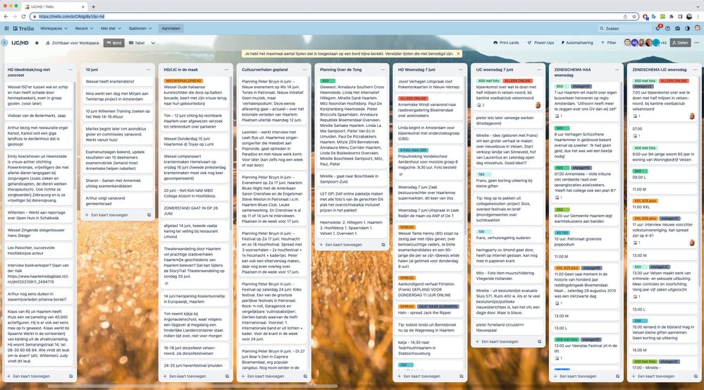

PeterD
June 7, 2023
This is a typical board for one of our departments, as you can see, the overview is great in Trello. Not being able to easily delete the lists of items that are already published is not a problem, but eventually the threshold is reached.

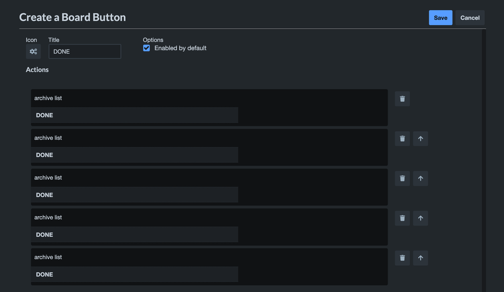

Theodoro Reato
June 8, 2023
There's a workaround for multiple lists with the same name, you can add multiple times the same actions,
Let me know if it worked.
