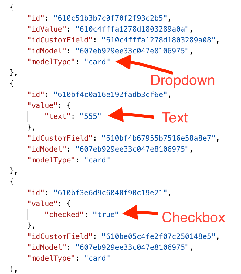

Hello, we have a power-up app on trello; however, we cannot get values of custom fields that are with type of "dropdown". Is there any way to retrieve?
API URL: GET https://api.trello.com/1/board/607eb929ee33c047e810692f/cards?customFieldItems=true&fields=name&key={key}&token={token}
Response:

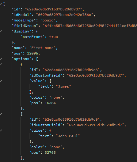

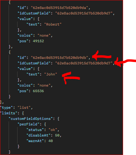

First off thank you so much for your answer. I'm facing the same Puzzle.
I went through your example and learned a lot.   I was able to complete it and get a list of all Options for my Custom field.
But how can I tell which option was selected?  The JSON doesn't reveal which option was selected by the user (that I can find).
Example:
I have custom field called: "First name", setup as a dropdown, and contains 4 options:
First Name
  James
  John Paul
  Robert
   John                 <<<<<==== Selected
If I select Option #4 "John" how do I perform a GET that tells me that this option was  selected?
User UI:
My Get call using the ID for my Custom Field "First Name":
JSON: Info on each option:
Apologies if I missed something in your example, I'm still Green with REST calls.

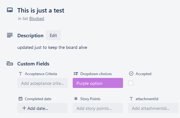

For example, I have a board with custom drop-down field called 'Dropdown choices' and it has four choices (I can discover the field and its options from the Get Custom Fields for a Board endpoint).
On one particular card, that custom field has been set to the choice 'Purple option':
I lookup the custom field items for that card:
GET https://api.trello.com/1/cards/631ed7381a8cfb00e091c317/customFieldItems?key=blah&token=blah
And the response tells me:
  "id": "631ed7381a8cfb00e091c317",
  "idValue": "60ce91cf104a13124295ec0e", <-- id of the option selected
  "idCustomField": "60cd9792d094da669588de05", <-- id of the custom field
  "idModel": "62c545eaaa69773929397646",
  "modelType": "card"
So, I then just compare the ID of the option selected for that custom field for that card with the knowledge I already know about that custom field via either the Get a Custom Field endpoint or the Get Custom Fields for a Board endpoint to reverse 'translate' the option ID back to the text content for that option.

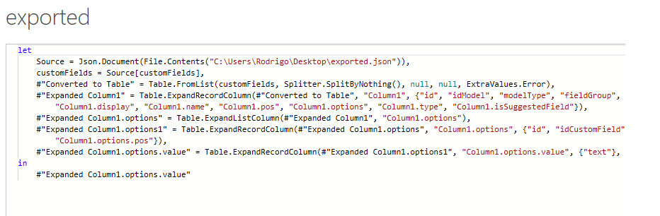

I never used API, but I do access the JSON file through Power BI. I believe the problem here is that you're accessing the "Cards" section of the database. This will bring the value set for the cards.
Instead, you should be going for the "customFields" portion of the database. Through that, you will be able to get all the data related to Custom Fields per se, like which fields you havem their ids, types, and 'Options', which is what you are looking for.
