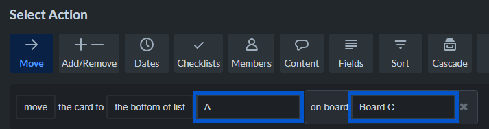

Thank you for the reply! I'm still having issues trying to get the check list items showing up on another board though. I'm following the commands you list on the post but its not giving me the option to look outside of the board I'm using. I'm not sure if I'm just over looking a step or what but I have the other steps down I think.
Hannah Humbert - Simpla Workflows
November 30, 2023
You can add an additional action to move the card to another board:image.png
