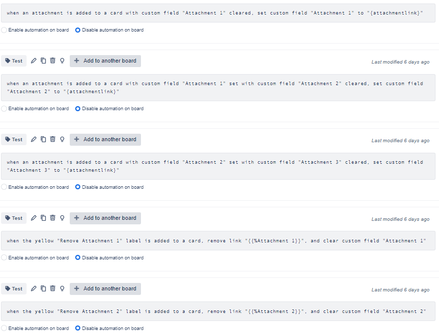

Hey Chris! Got it! I was testing here and to add more attachments you can change the automation a little bit.

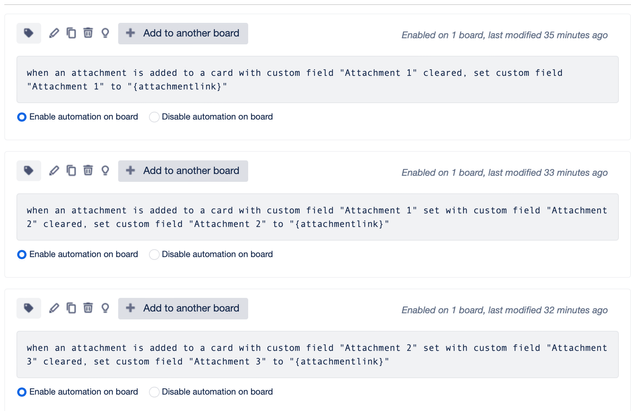

First, you'll need to create a custom field for each attachment you want to add. So, in case your card has 3 attachments, you'll create 3 Custom fields (like Attachment 1, Attachment 2, etc).
Then, create an automation rule for each one using some filters to avoid one link overriding the other.
Here's my example:

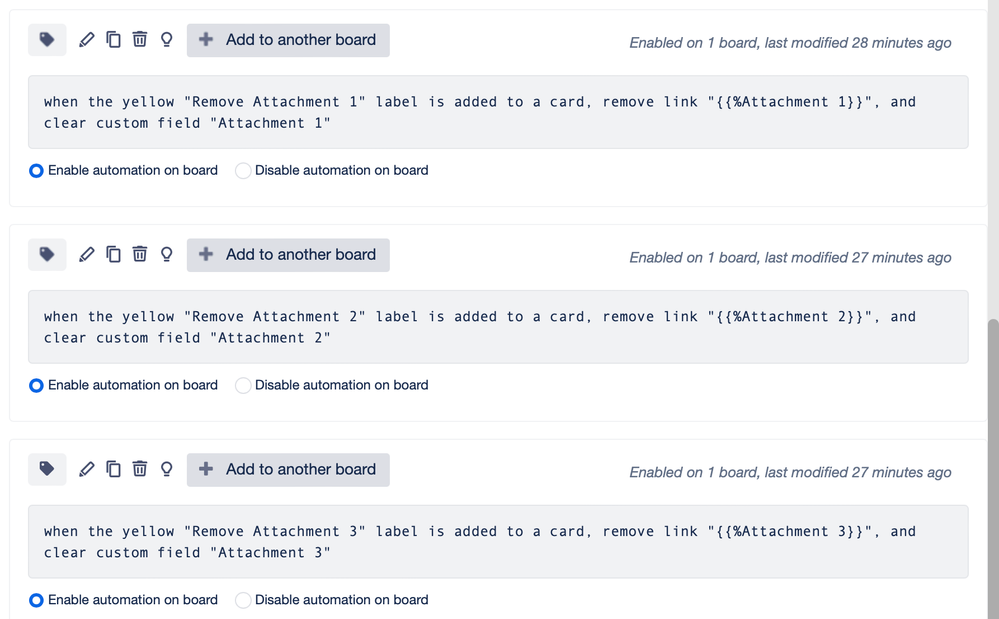

Then to remove the attachment, you'll need to create a rule for each attachment that would be deleted using some labels as trigger. Here, I created 3 labels to correspond to each attachment.
Example:
Hope that helps!

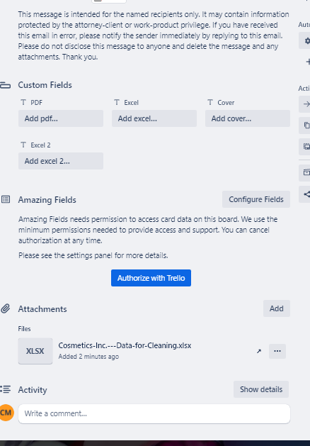

It def helped, but I am coming across a single issue following this format. It seems to work half the time, while failing the rest. From what I can gather, it seems to fail when there are two different document types sent as an attachment (excel and PDF to be exact). It seems that If the excel is set to the attachment 1 slot, then both documents are removed. However, if the PDF is set at the attachment 1 slot, the process does not remove the excel as the second attachment. Is there any reason for this? Can the custom fields be used to removed specific document types so this issue does not occur again?

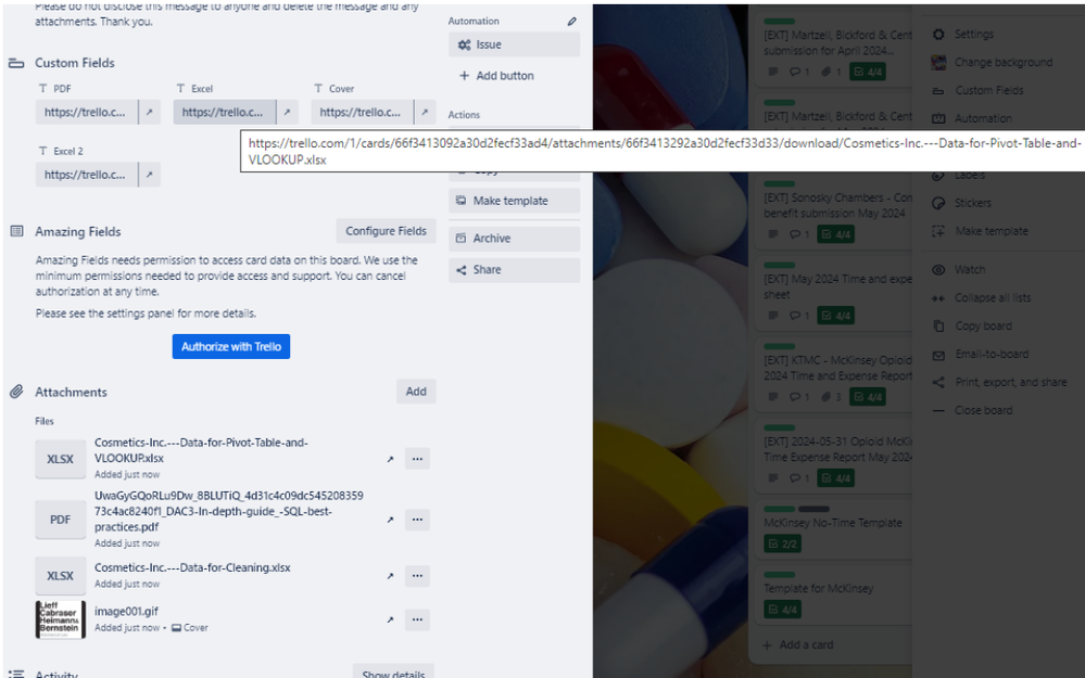

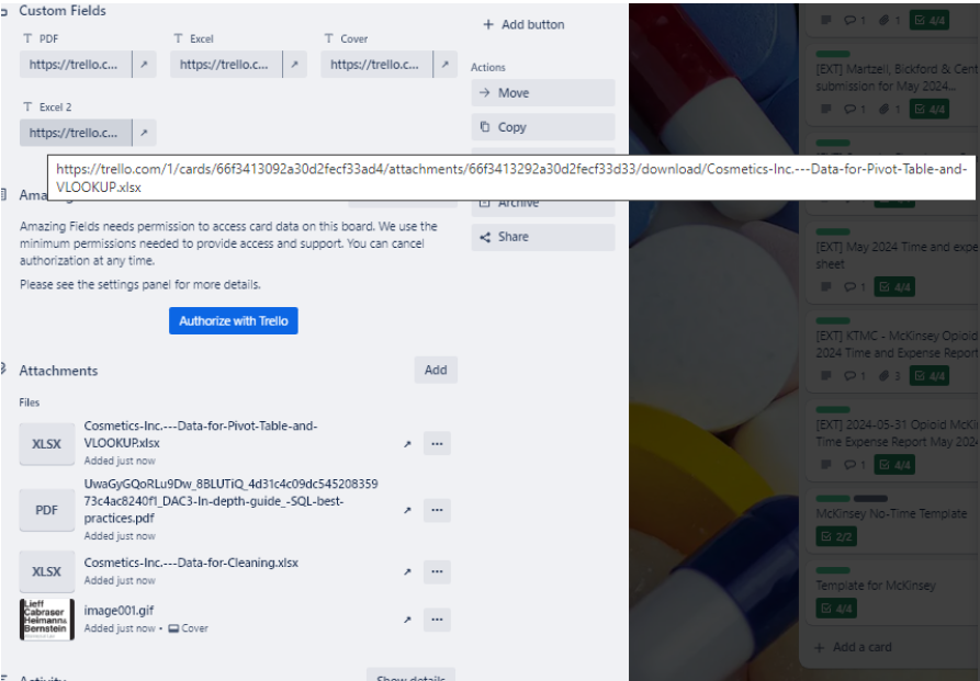

Actually I was able to get around this, but I had one issue remaining. It seems when I have two documents of the same type and are trying to separate them into different custom fields with the example shown above, it will put one in a custom field then replace it immediately with the second one. For example I have two custom fields Excel 1 and Excel 2. Using the process mentioned above, Excel 1 & Excel 2 will be filled with the first attachment at the same time, but then gets replaced with the second attachment in both fields. When it comes to the label to remove them, only one gets truly removed while the other remains as an attachment as it is unable to remove it due to the link not matching. (All attachments are public items with nothing in the body)

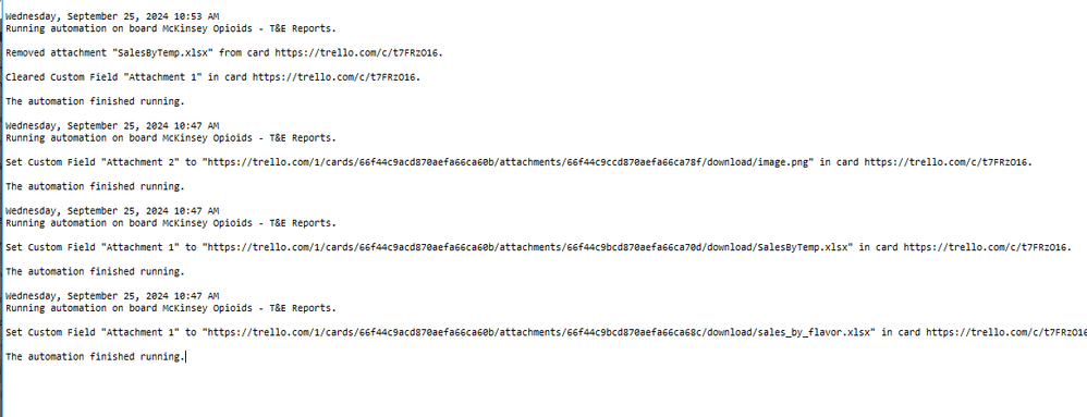

The behavior for all file extensions should be the same. Can you kindly check the automation log for any error messages?
Also, it would be really helpful if you could send us a screenshot of your rules. This will allow us to review them more easily.

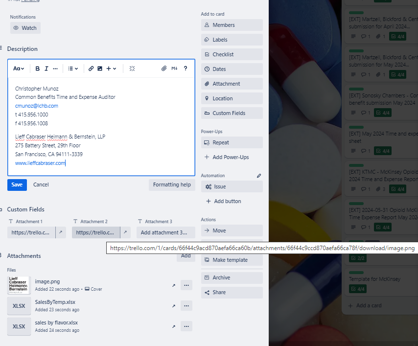

Hi Carolina,
I had only went this method as it was actually effective in removing more than one document type. It seems when I use the example above, any document of the same type just gets replaced by the other. Screenshot is below, but as you can see, the XLSC file titled Sales by Flavor gets triggered then replaced by the other. When triggering the removal automation, only the one remaining in the custom field box gets removed.

Hi Carolina,
Yes, the examples above only had the 6 rules set up and followed exactly how she had it placed. I did change them up after the fact as I needed a fix now than later, though I still have the same issue as mentioned before. It just seems to to be an issue when the attachment are an excel/same document. It replaces the document instead of placing an attachment in one custom field, reading it as filled and placing it in the second or third. The process has no issues if each document is different. It will place a PDF in one, notice it is filled, place the excel in the second and jpeg/other document in the 3rd slot. I', trying to figure this out but I am not having any luck. Example of the rules below, they are disabled now but were enabled when testing.
