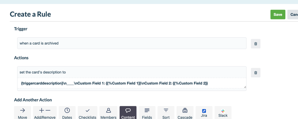

Another option would be to have a trigger that appends all custom field values at the time your card is archived to the description of the card, something like:
The trouble with this approach obviously is that you would need to manually update your Butler command whenever you changed the custom fields, and you would have to create a separate Butler command customised for the custom fields on each board, and if you forgot, you would lose that data.
