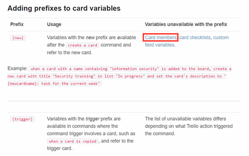

Am I right in assuming you're trying to copy the members from the trigger card to the newly created card? If so, it's not possible to use the trigger pre-fix with member variables:
Thank you for clarification. I haven't realized that the trigger prefix is not supposed to work...

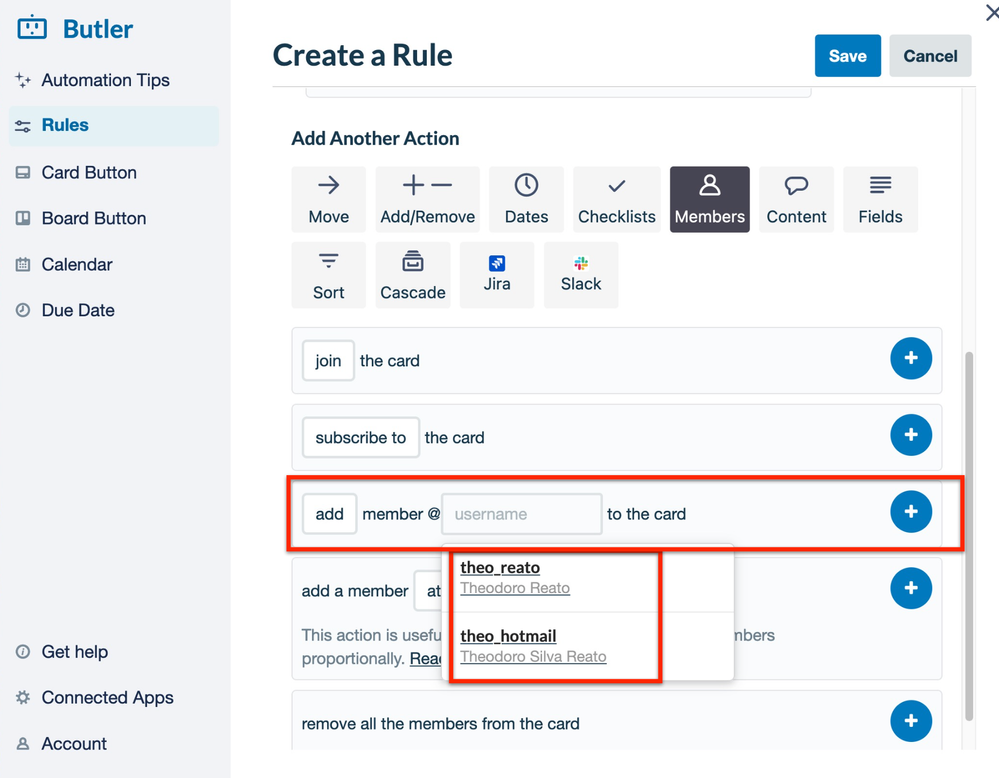

Hum, I tried to copy a card and add a member to the card, and I was able to do it with the Members's tab, as you can see on the image below.
Looks like you are adding the wrong parameter to add the member, as you can find on this article it should be @{{%triggercardmemberusernames}} (if triggercardmemberusernames is the name of your custom field). Can you test it?
