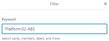

Expanding on the solution that @WG Trello Admin provided earlier. I was able to filter custom fields using the following (both produced the same results, just different ways of applying the filters):
In the two examples below, I am trying to filter a custom field named "Platform" and only want values that match "02-ABS" returned.
1. Passing filter arguments on the URL:  https://trello.com/b/Hs3xo5st/chemicals?filter=Platform:02-ABS
The bolded section in the URL is what I added to have my cards filtered.
2. In the filter, under keyword:
Platform:02-ABS

I don't get this to work for me. I may get all the cards I want filtered, but I also get cards that don't have any value in the custom field or a different value. In the custom field name and the defined values for the custom field have two or more words and a space between the words. Does this make it more complicated for Trello to get it right?
Alex Gorman
February 10, 2022
Hi @Marit Pernille Børstad ! So, it does appear to be an issue when accessing custom data fields with spaces or custom data field values with spaces. In my testing, it does filter out some cards, but as you said, it retains ones that should be filtered out. Not sure what's going on here, so will need to investigate this further. I'll report back on my findings.

If I add a filter like this: filter=Initiative:Hotel-Onboarding-Program shows me cards without this value in the custom field
