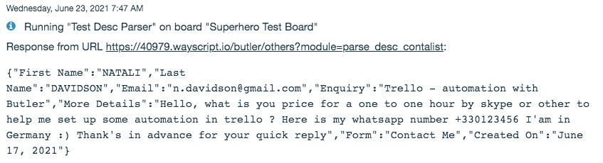

For larger dataset, I would suggest using HTTP request to an endpoint. The {httpresponse} will be in key:value pair which you can use it to set the custom field values. You can extend your endpoint to handle the CF updates.
See https://trello.com/c/ULsKwRLh/43-parse-card-description-for-key-value-pairs-simpl
This is a sample output from Butler console for a more complex card description from a webform from Contalist. It shows the http request from Butler.

It can be done with Butler. You just need to be very careful in building out the command. Here, I am relying more on the structure and using the names (keys like name, address, email etc) instead of hardcoding. It can be use for any card as long as the structure remains unchanged.
