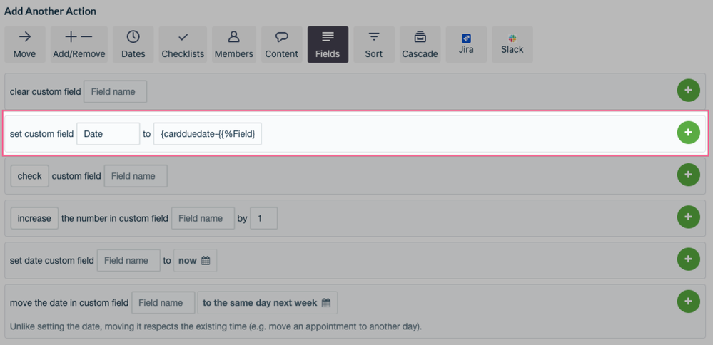

Hey @Stefan
You're quite close to having this set up, but there's one trick you'll need to do, to make this work.
Currently setting a date field doesn't allow for that variable manipulation, so you'll need to use a different option in Butler. Fortunately, you can manually enter the name of the Date field and use a variable as the value.
With that, and some arithmetic formatting, you can get the other field to subtract that set number of days as well.
Here's the action in Butler:

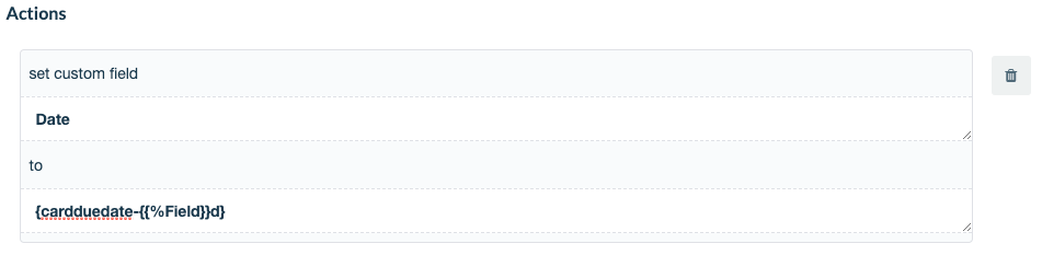

Also, here's the formatting after it's added to the command:
Give that a try and let me know how it goes!
Stefan
April 23, 2021
Thank you very much for helping me with my problem, everything works great now.
I would never have tried to use the "set custom field xxx to" because it wouldn't allow to pick it out of the list.
