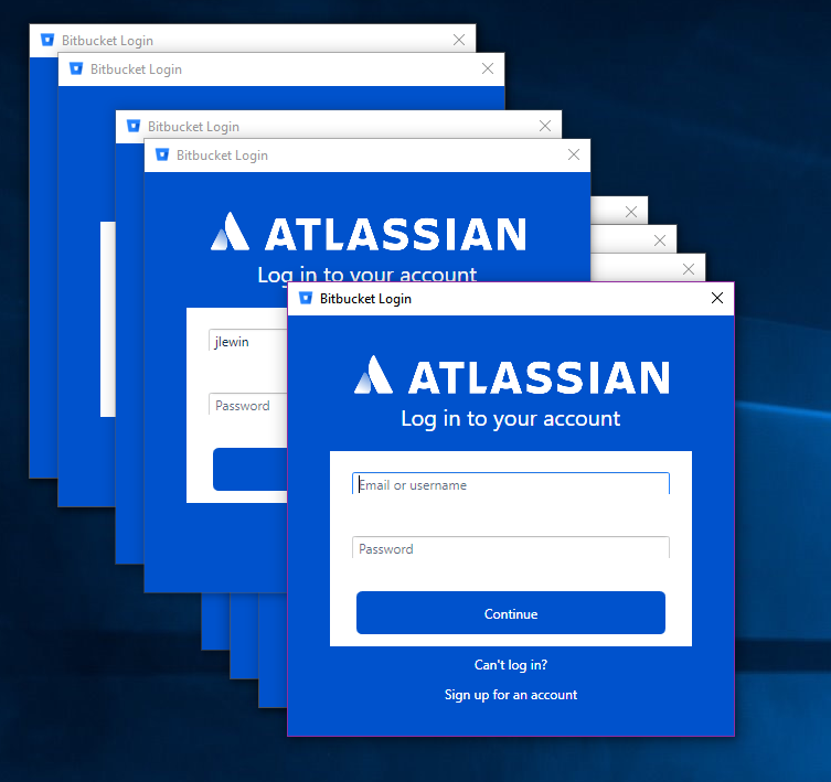

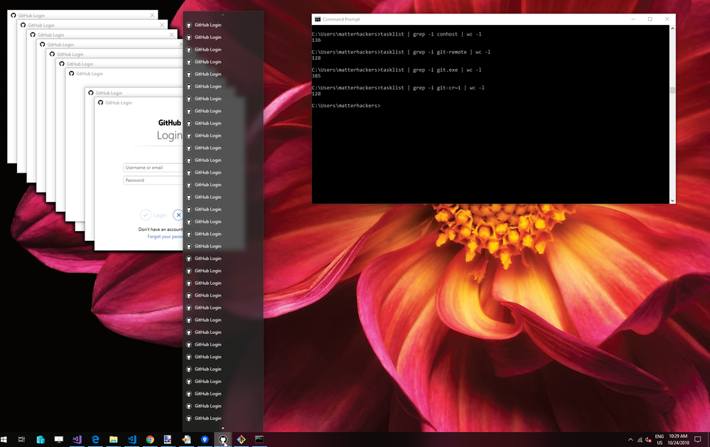

If l accidentally leave recent builds of SourceTree running overnight, I arrive to hundreds of authentication dialogs tiled across the screen. Right clicking the toolbar icon and choosing `Close all windows` drops the current batch but then hundreds more start reloading. I have to repeat numerous times to restore order
Environment
SourceTree Version 3.0.6-beta-2193 but has been regularly occurring for a week or so
Expected
One dialog if authentication required
Actual

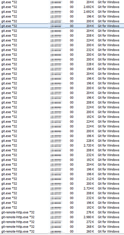

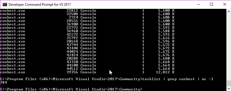

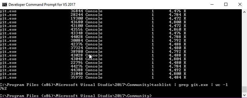

I'm not entirely certain that SourceTree is responsible for these counts but it seems highly likely the Bitbucket login screens are related to the ophaned processes listed below. Before I reboot to try and make my machine usable again, the following seemingly orphaned processes are running after SourceTree and all applications are closed down:
git.exe: 762 instances
conhost.exe: 385 instances

After update from 2.6.10 to 3.0.6 my colleague and I had problems with sourcetree which was constantly asking for my password.
I also detected lots of processes git.exe.

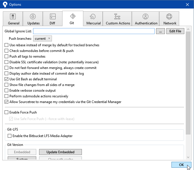

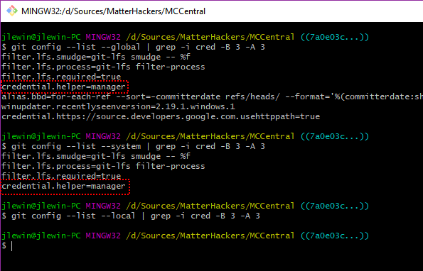

Seems like the GCM is not set to the be the credential manager for git. Can you run the following command via the terminal and reply with the output:
git config --global
You should be looking for:
credential.helper=manager
After doing that, can you open the Windows Credential Manager (go to 'Windows Credentials') and look for an entry with your username that looks something like "git:https://USERNAME@bitbucket.org" and verify that exists?
Additionally, can you verify that in Sourcetree the setting "Allow Sourcetree to manager my credentials via the Git Credential Manager" is checked (Tools > Options > Git)?
John Lewin
October 19, 2018
Really appreciate you continuing to think through this. My Bitbucket account may be at fault as at times in the past it also put up annoying dialogs that kept coming back after authentication. I usually go in and try to remove all cached credentials for Bitbucket after I connect to an old Bitbucket repo through Sourcetree (we moved to GitHub a few years ago). However, the new behavior is on a whole nother level and pretty much brings my computer to its knees if I leave Sourcetree open overnight.
GCM looks to be configured:2018_10_19_15_16_16_Window.png
Allow Sourcetree to manage... is and was enabled.
2018_10_19_15_20_22_Window.pngStill getting the AskPass error in Sourcetree on the non-public repository. Fetch works without issue from the command line. Fetch works in Sourcetree on public repositories

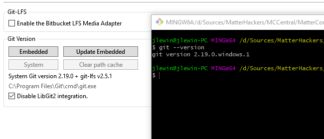

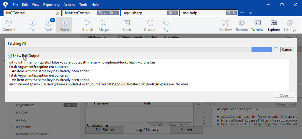

jlewin
October 17, 2018
This behavior has been occurring on my work machine which as of last night was configured with System Git 2.19.0. Based on your recommendations I upgraded Git to 2.19.1. Unfortunately I'm now running into a blocking bug I've previously commented on (AskPass Error: No error) which prevents SourceTree from syncing successfully on some of my repositories until I switch to Embedded Git.
I haven't yet seen the error dialog but things aren't in their typical state given the Askpass error. Further, the naming of the component under error (AskPass) strongly suggests that it may have been responsible for the problematic behavior to begin with. If the blocking bug gets fixed and the errors don't resume, this issue may be resolved as suggested.
https://community.atlassian.com/t5/Sourcetree-questions/Error-Askpass-exe-No-such-file-or-directory/qaq-p/908286

Mike Corsaro
October 18, 2018
That askpass error is happening due to the git-credential-manager-for-windows not being triggered. Could you download the latest version of that and see if it fixes it? You can find it here:
https://github.com/Microsoft/Git-Credential-Manager-for-Windows/releases
