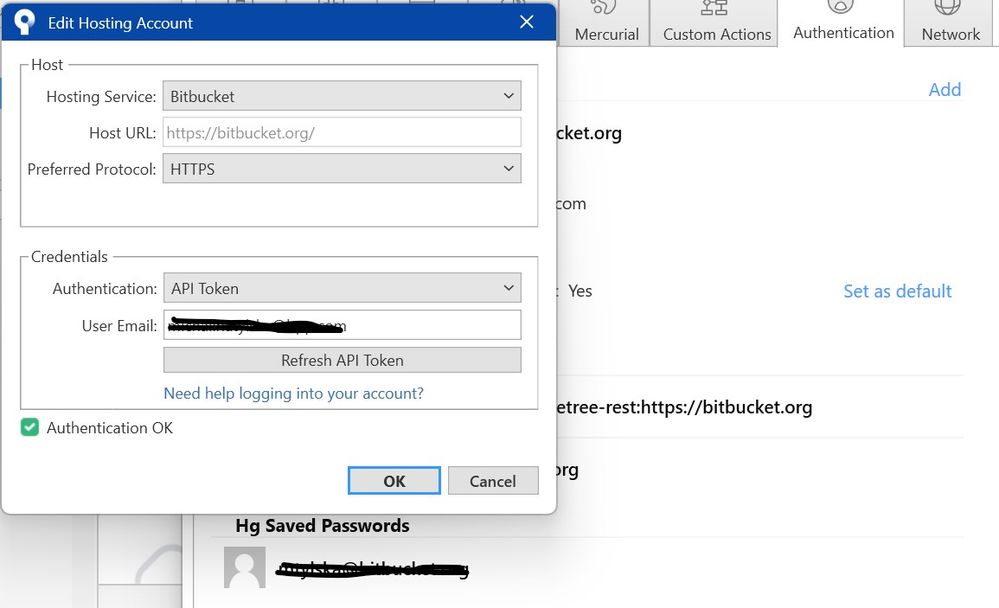

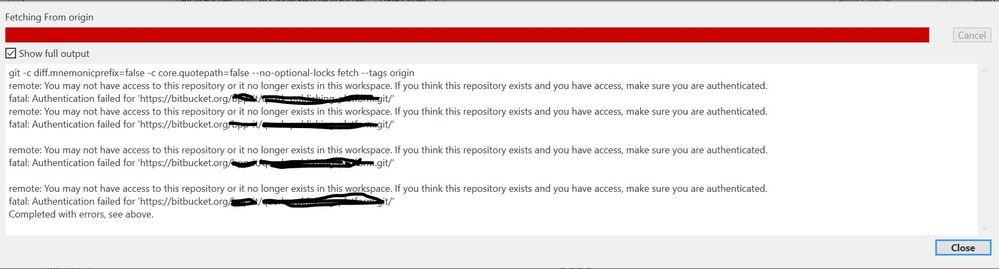

I'm authenticated on SourceTree (via API Token) yet I can't fetch, push to remote repository:

Hi @Tomislav Tobijas ,
Thank you for this.
I have tried clearing Credentials and reinserting API token and that didn't change anything.
For the OAuth seems like that didn't change anything as well and error still occuring.

Thanks! I'm on Windows 11 and I got the latest version of SourceTree: 3.4.31. I tried adding API token to URL and still get the error. I had run through this forum for few days now and tried few (if not all) suggested fixes but still no luck so I decided to post myself to see if that would get me anywhere.

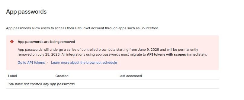

I also noticed that after creating API token there is nothing showing up in my App passwords on bitbucket, where before there were there..
So not sure why they are not listed anymore?
@Michalina Tylska related to API tokens (if you're using personal ones), these are actually listed here: https://id.atlassian.com/manage-profile/security/api-tokens
So, not under App passwords anymore but under your Atlassian Account > Security > API Tokens.
I suspect that "App passwords" page will be deprecated or removed at some point.
