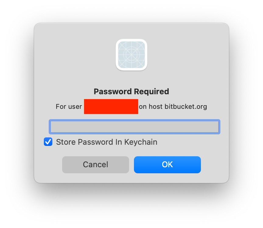

When I try to push a commit from SourceTree to my git repositories on Bitbucket, I'm still getting periodic "CHANGE-3222 - Functionality has been deprecated" errors. I get the same error if I try to clone one of my remote repositories.
How do I go about making SourceTree work with API tokens?

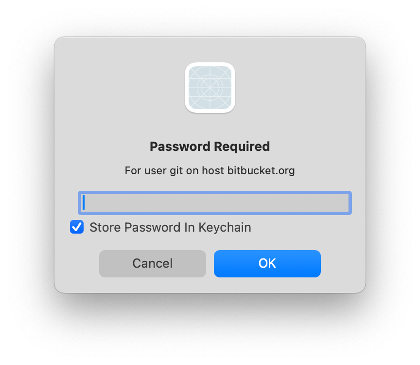

I worked on our repos all day and right now, all of a sudden, the git@bitbucket.org method is not working any longer. It say I don't have permissions. WTF?
git@bitbucket.org: Permission denied (publickey).
This must be a joke

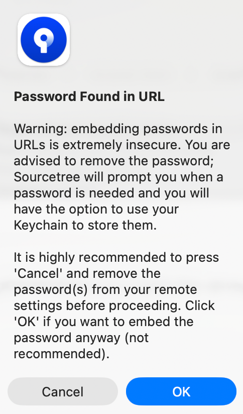

And SourceTree gives me this warning when I configure things using the only approach that works. Come on Atlassian, this is a serious product - why are you leading us down a path that is clear so wrong - even the product that is the subject of this thread says so.

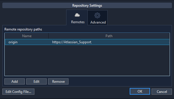

Potentially Sourcetree cached old credentials in the local repo config. You could open repo in Sourcetree > Settings (top right) > Remotes and check the origin remote. (select 'edit')

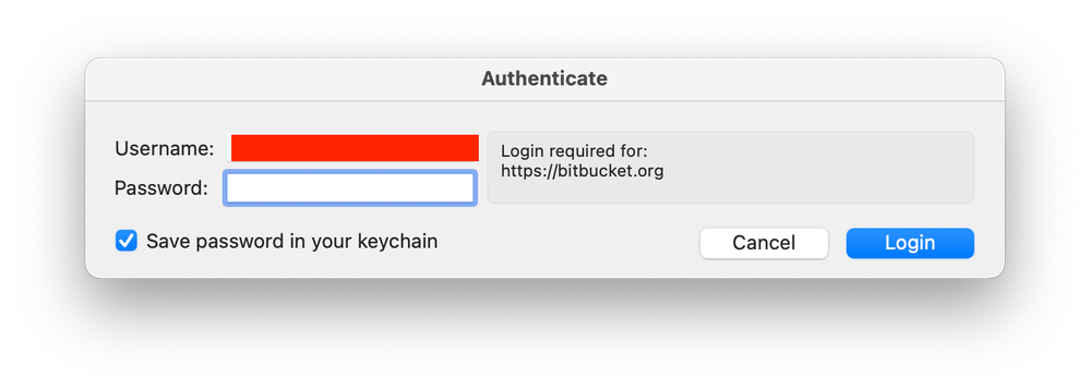

Thanks for the suggestion @Tomislav Tobijas! I've tried what you've suggested and got SourceTree into even more of a mess now…
remote: You may not have access to this repository or it no longer exists in this workspace. If you think this repository exists and you have access, make sure you are authenticated.
fatal: Authentication failed for 'https://bitbucket.org/…/'
Editing the account and changing back to basic auth with the app password that I was previously using resolves this, but that is of course going away soon.

Previously it had:
'https://{Username}@bitbucket.org/...'
I had changed this to:
'https://x-bitbucket-api-token-auth:{APIToken}@bitbucket.org/...'
Apparently this is one way to kind of force SourceTree into communicating with Bitbucket using the generated API token instead of trying to utilize previously stored credentials. The only downside with this is it can store the API token in plain text, but since I'm the only one who ever uses my computer, it's not really a concern for me.
