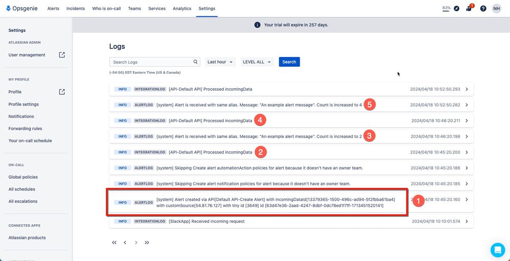

Nick Haller
April 18, 2024

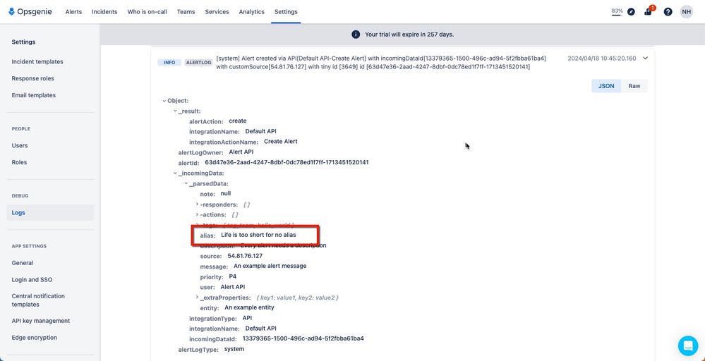

If an alert was created, there would be a log such as the one below (1) that shows the alerts tiny ID and "Alert created":

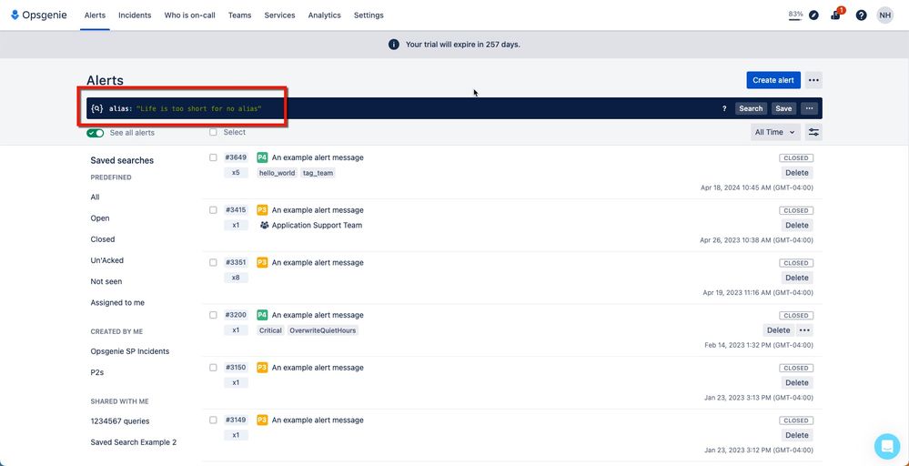

Notice logs 2-5 - those are for deduplicated alerts/requests that increase the count of an already existing open alert. Maybe your request is being received and rolling into another alert. I would run a query on the alert's alias to see if that's the case and if currently exists in your Opsgenie:
Otherwise I would review the logs a bit further to see if the payload received gives any more insight into what might be happening with the request.
