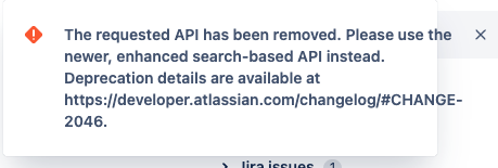

We have a Jira Integration set up that will create alerts in Opsgenie based on specific conditions on a work item. These alerts should display the associated Jira work item on the alert. However, when expanding the section, no Jira work items shows.
It looks like the page is making a bad request to Atlassian, and we are getting the following error toast. As far as I can tell, I am unable to update the API that this integration is using, as it is all configured in Opsgenie.
Screenshot 2025-08-20 at 3.17.43 PM.pngScreenshot 2025-08-20 at 3.17.05 PM.png
I have tried to delete and recreate the integration, but I am still seeing the error on newly created integrations.
Is there anything I can do to resume showing the link to the Jira work item on the Opsgenie alert?

@Nayan Pandey Thank you for the link to that request; however, this was a previously working feature. These integrations were already in place, and they previously linked to the Jira issue that created the alert, and we were not getting that error.
The error message suggests that the API to retrieve the corresponding Jira issue is now deprecated and needs to be updated. As we are using the built-in Jira in Opsgenie integration, this is something that I believe Atlassian needs to update.

You are correct. I've had a chance to test this behavior on my lab instance, and I can confirm that links are indeed being added to Opsgenie alerts, just as you described.
To help us understand and resolve this for you, would you mind creating a support ticket with us on https://support.atlassian.com/contact/#/? It would be helpful if you could also include a HAR file collected while you're replicating the issue. This will give us the insights we need to investigate thoroughly.
