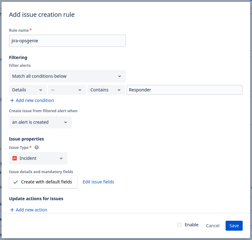

Looking at the 'Add issue creation rule' in the opsgenie integration, I'm not seeing the option to match based on key-values (the closest I can get is 'Details Contains Responder). How can I match on Key-Value?

Hi @Hendrik Moens ,
I just tested this.
This new framework's filter matches the string in the Extra properties (Details) regardless its Key or Value.
So, my suggestion is to make it match the string "Responder" like this:
Hope this helps.
