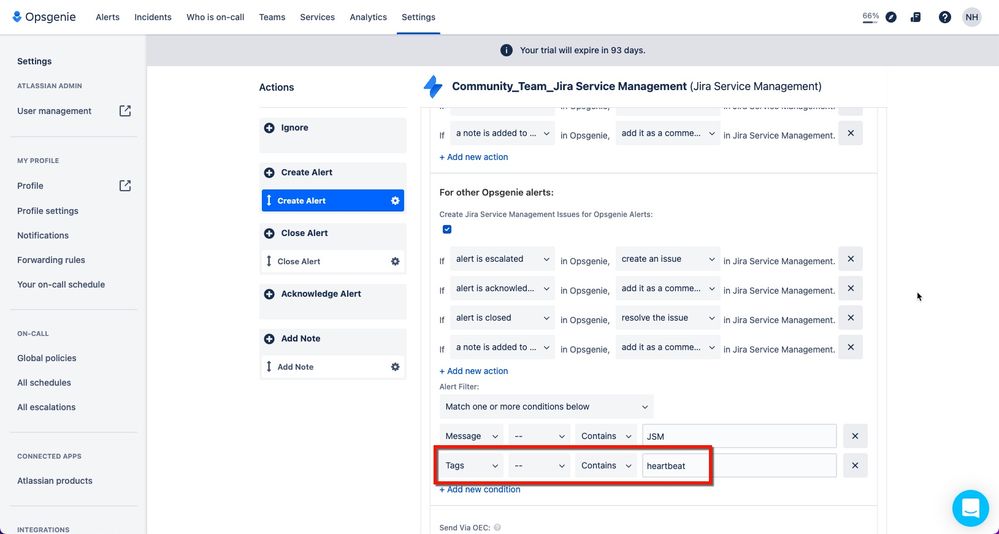

That should be possible. If your JSM integration is configured under a team, then the heartbeat should be configured under the same team as well. The integration would only trigger on alerts sent to that team.

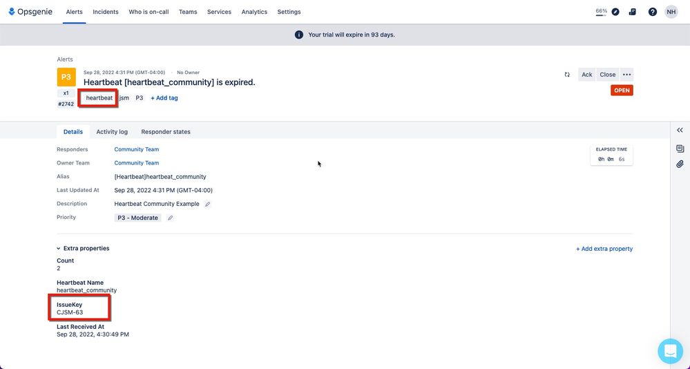

You'd want to have the outgoing flow of the JSM integration create issues for these types of alerts. Here's a configuration I have that was successful in creating a JSM issue from a heartbeat alert. Both the integration and heartbeat are configured under my Community Team:

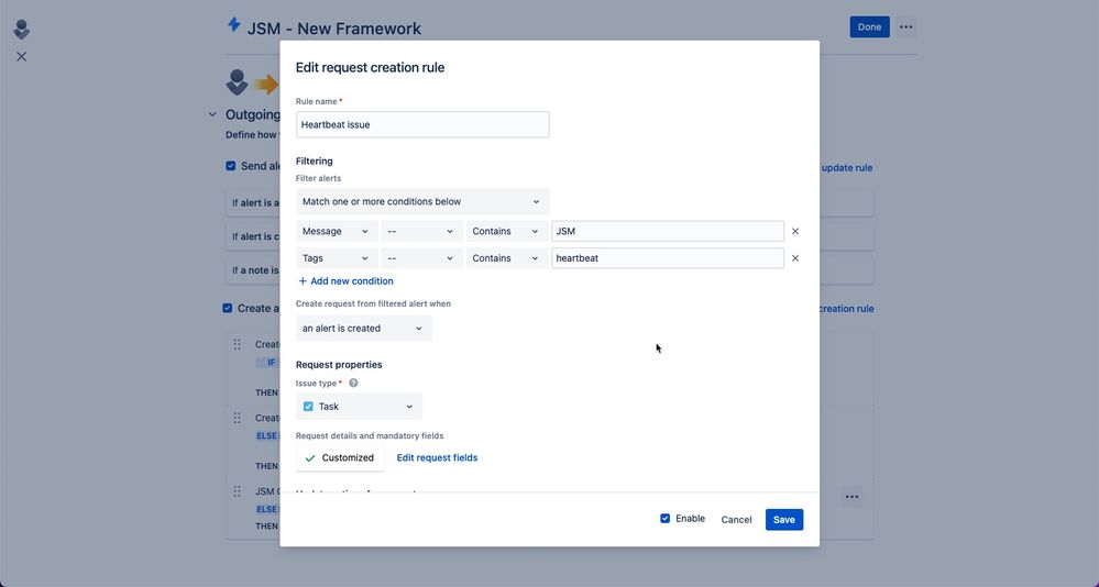

The JSM integration above is our legacy integration. The idea would be the same with the JSM cloud integration under the Outgoing automation rules section - if you are using this instead:
