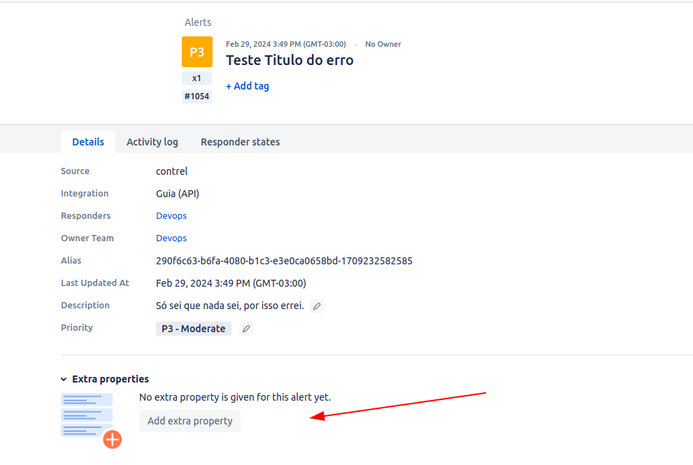

This is result:
what is wrong?

Hi @Bruno Willian Conke das Neves ,
The JSON body (which looks correct) you shared compared to the screenshot looks to be a for different alert?

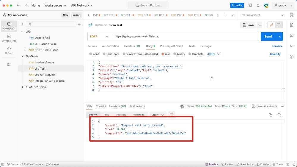

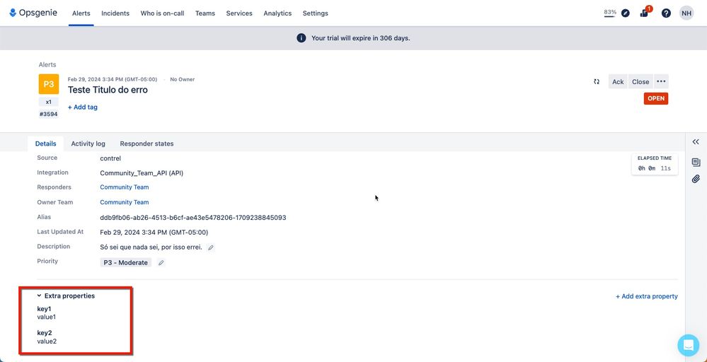

Nick Haller
February 29, 2024
Hi Bruno,
Thank you for sharing that.
Testing in Postman with the same body shared above, I created an alert as expected with the details (extra properties) added as expected:

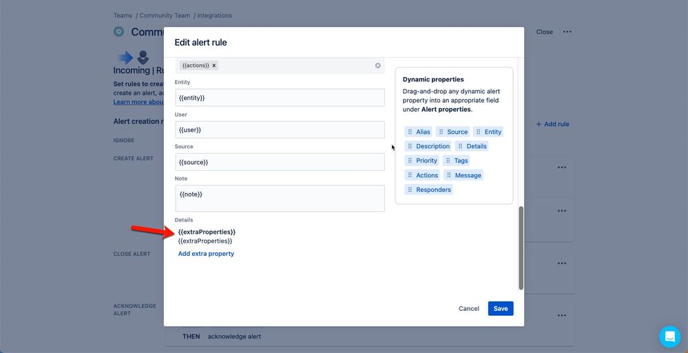

One thing I would suggest also reviewing is the create alert action being used for this alert in the API integration. Maybe the action is wiping the extra properties at creation, and should at the very least have this configured to dynamically parse those fields / values:
Otherwise Opsgenie support should be able to assist further.
February 29, 2024
Hi Nick,
That was it, thank you very much.
