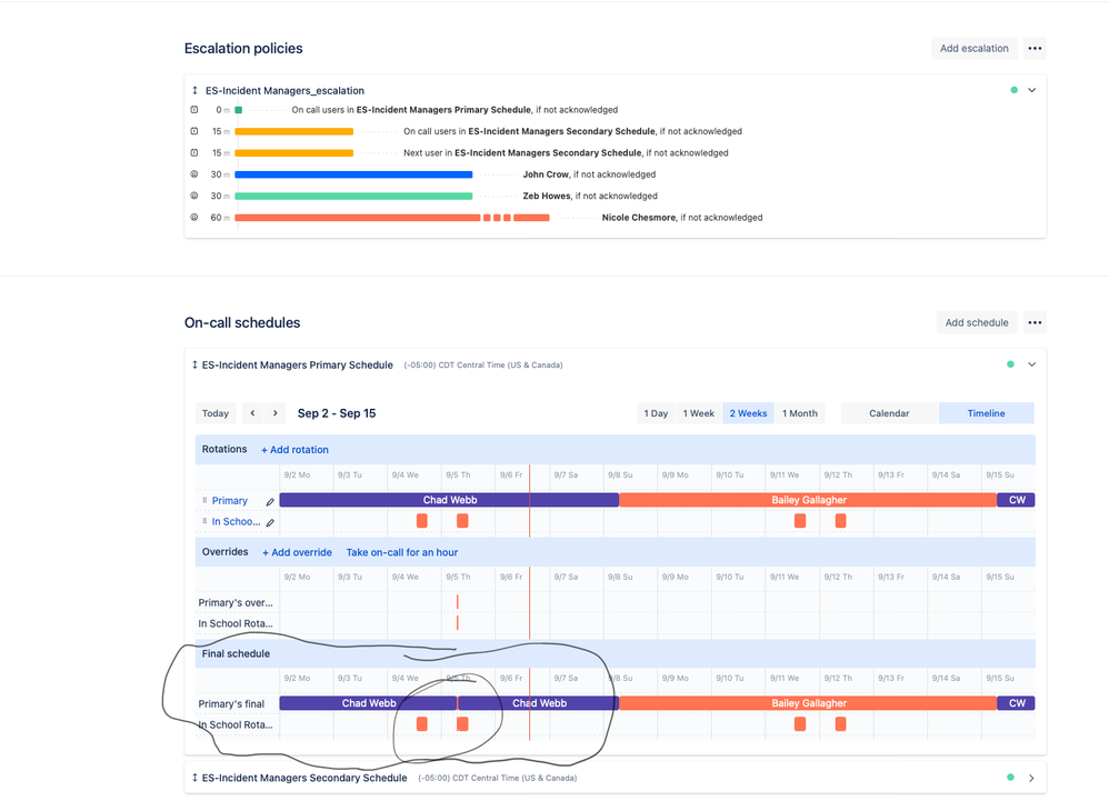

Our multiple rotations are no longer merging into one final schedule. How can we merge the rotations back into one true final schedule?
Between 2 incident managers overrides on the schedule are not merging into one final schedule. Both regularly scheduled incident manager and person for override are being alerted at at the same time.

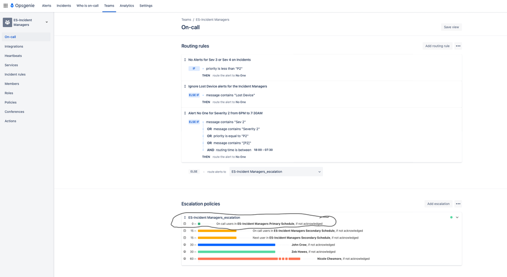

Hi @Bailey Gallagher
Would you please provide a screenshot of your team configuration, including routing rules and escalation?
Thanks.

Hi,
The final schedule is per rotation.
When configuring on call schedules, you have two main entities:
  • schedule, which is the calendar itself
  • rotation, which is the rotation rule within a schedule. A schedule can contain multiple rotations
When configuring an override, you can also select to which rotation that override applies to.
So the final result is working as expect. If you want the override to show up in the "primary's" rotation, please make sure to select this rotation when setting up the override.

@Eugenio Onofre  I have been doing that when I go to add my override I add it to "primary schedule" then I select the person who I want the override to make as primary. Regardless of doing that I am experiencing this issue.

@Bailey Gallagher
Thanks for the information. Based on the screenshots you provided, seems the wrong rotation was selected when creating an override.
I strongly recommend opening a support ticket with Atlassian then!
