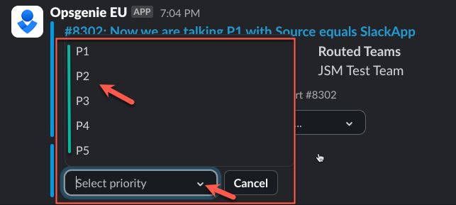

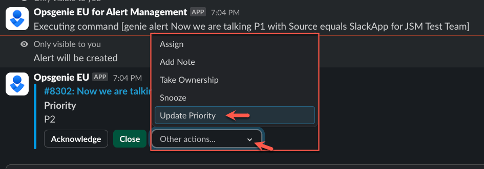

To see the alert Id, go to the Slack channel receiving the notification messages from Opsgenie to send the "/genie alert Test Alert for Response Team" command.  That way, the user would have the tinyId and a way to change the alert priority via the Slack alert dropdown.
The following screenshot is an example of a Slack Message from Opsgenie (via the Slack integration -- make sure the "Create" Alert action is check at the bottom of the Slack integration. This will cause Slack messages to be sent when alerts are created)
How do you update the Opsgenie alert Priority?
1. If the user creating the Opsgenie alert from Slack has access to the Slack channel receiving the slack messages from Opsgenie, then they can update the alert priority via the Slack message > click "Other action..." > select "Update Priority" > to update the alert priority
