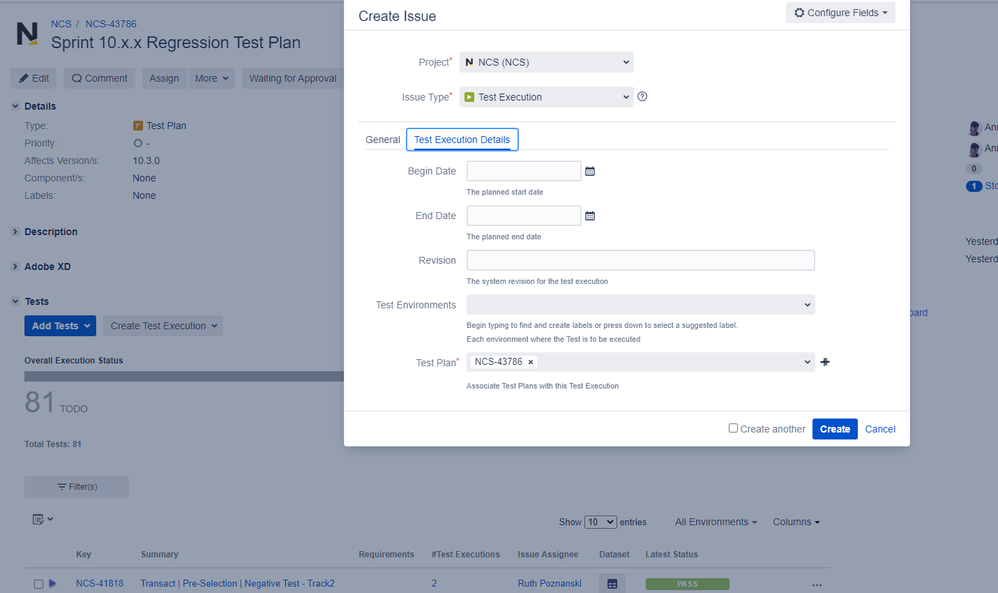

Anna Lucovsky
February 15, 2022
Hi @Stefan Salzl ,
Thank you! Please see the screenshots attached.

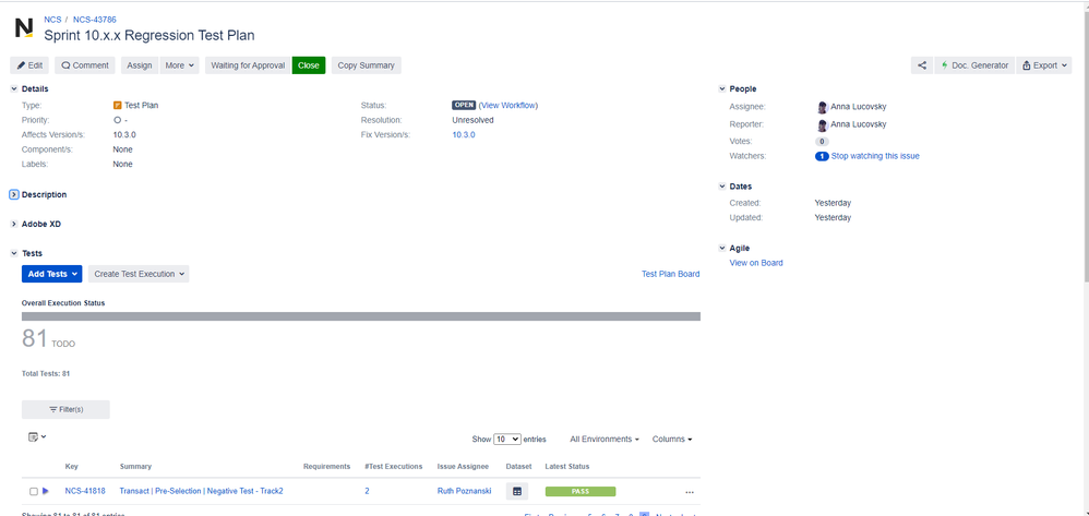

Test Plan:

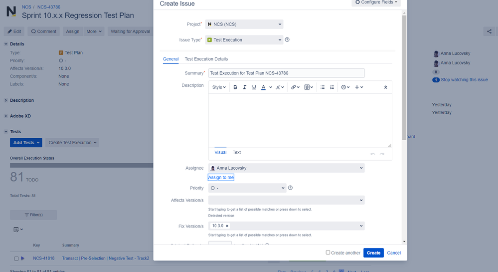

Create Test Execution (All Tests):

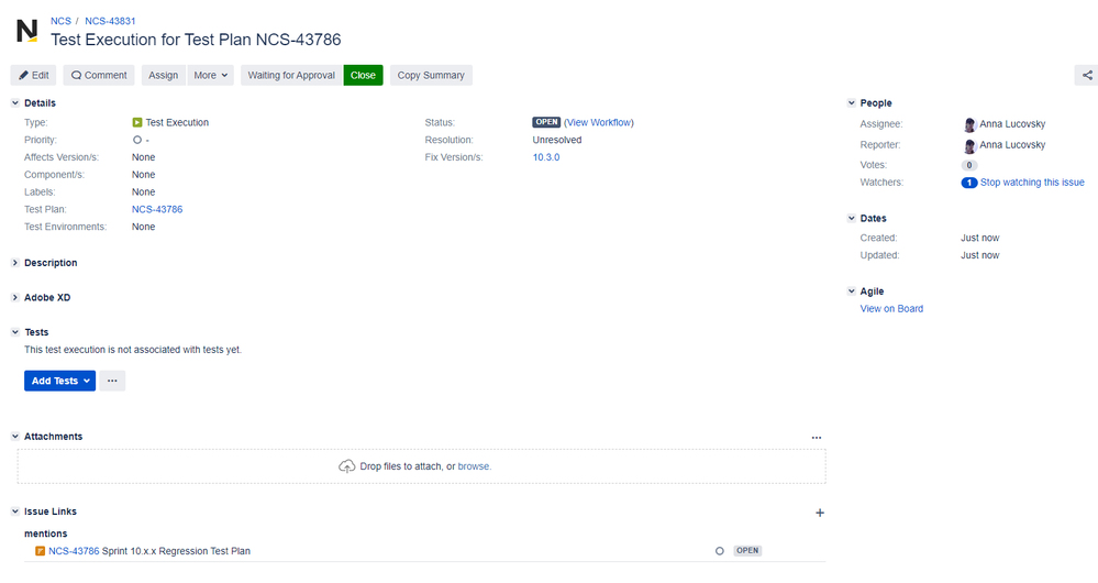

Test Execution:

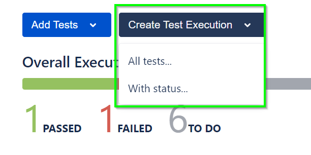

Stefan Salzl
February 15, 2022
Thank you very much @Anna Lucovsky
There should be a setting when clicking the "create execution" button regarding which tests you want to have in the new test execution (all, only a certain test status,....)
  • So when you click "create execution" do you see something similar to this:
  • and if so: which option did you chose?
Thanks in advance.
Best
Stefan

Please ignore my last answer. I just saw that you mentioned the "all tests" in the first screenshot.
Sorry for the confusion.

Stefan Salzl
February 15, 2022
Hi @Anna Lucovsky ,
From your screenshot everything looks fine (unless that there are no tests listed during creating the execution).
Did this work in the past and is now a new behaviour?
What came to my mind is that there could be a correlation with permissions/statuses. There is a special setting for allowing executions of tests in certain statuses or with certain assignees (see link below):
https://docs.getxray.app/display/ProductKB/%5BXray+Server%5D+No+permissions+to+execute+Test+Executions
Could you please check those settings?
Best
Stefan

Stefan Salzl
February 15, 2022
Hi @Anna Lucovsky ,
I see :) Sure will find a solution to this ;)

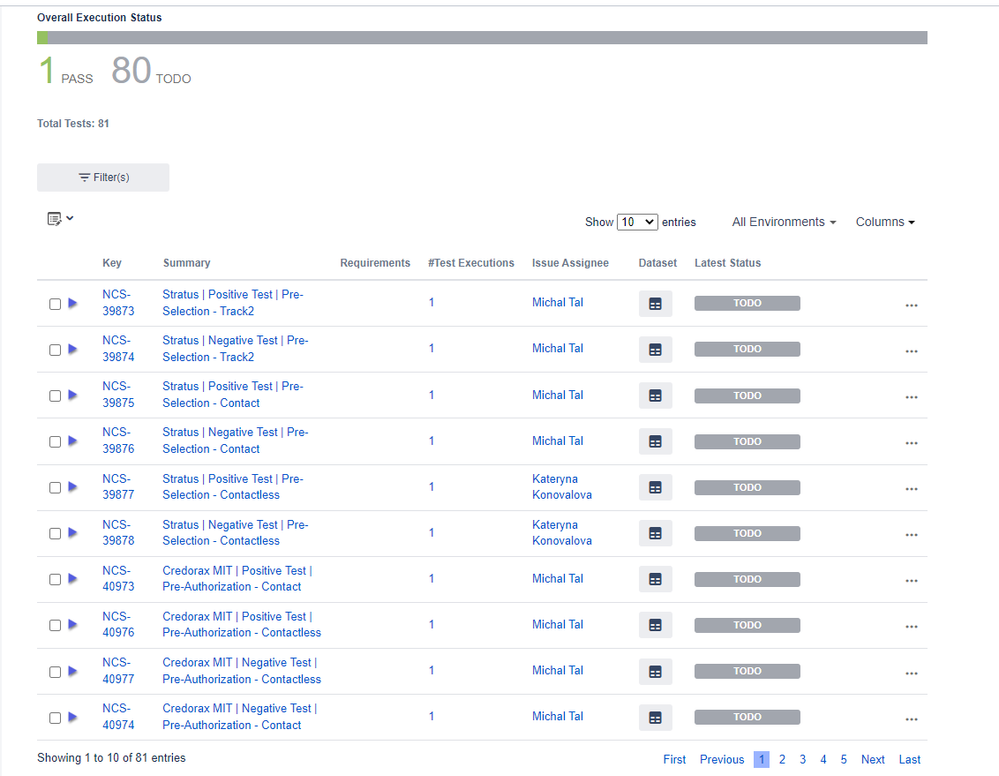

There is one thing in your first screenshot that kinda confuses me:
It shows one testcase in the list that says passed but the overall execution doesn´t show any passed part but all 81 testcases in "to do". Could you please who the whole testplan issue (including the list of tests).
Furthermore could you check if you are allowed to edit the testplan issue?
Best
Stefan
Anna Lucovsky
February 15, 2022
Hi @Stefan Salzl ,

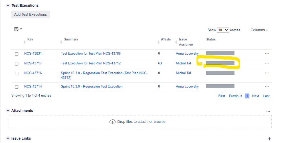

Please see the test plan. There's one execution we've attached (and added tests there separately), which has one passed tests, just to see the results.
Best,
Anna

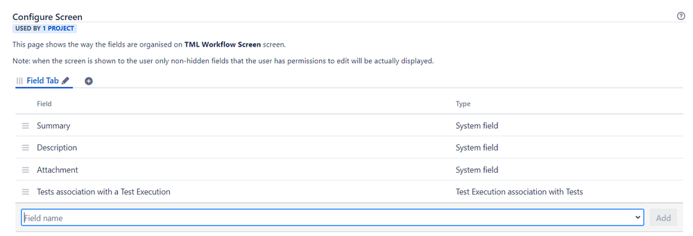

Please follow the following steps-
  1. Goto settings
  2. Create new screen or configure existing screen.
  4. Make sure you have added above screen, into screen scheme and used in project. Also make sure you have added into the issue type screen scheme.
If you have followed all the above steps then I hope you can see the test cases from test plan into test execution.
