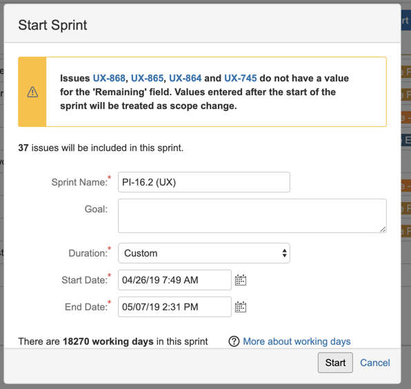

Has anyone else seen this.  When starting a sprint in a particular project I am getting the following:
Start Date: 4/26/19 7:49 PM
End Date: 05/07/19 2:31 PM
There are 18270 working days in this sprint.
Ummm  April 26th to May 7th is not quite 18,000 + days???

Could you please let us know where are you seen the number 18270? Can you please send a Screenshot of this?
Analyzing the information you provided a little bit further, It seems the number you are seen is, in fact, the minutes between the Start and End date. I can explain it in a simple calculation:
- You have 13 days between both Start and End date
- 24h per day: 312 Hours
- 312 Hours x 60 (Minutes per hour) = 18720 - A similar number to the one you found
That been said, I believe that something might be misconfiguring the report or View you mentioned.
If this information does not help, please provide us with the requested screenshot so we can further investigate what is causing the issue.

Hi @Petter Gonçalves I have shown the picture is there anything else you need from me?  Should I open a Atlassian TTK?  Thanks so much, Robert

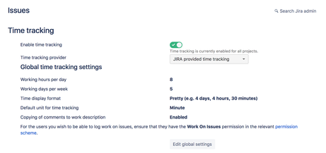

- A screenshot of your time tracking configuration (JIRA Settings > Issues > Time tracking):

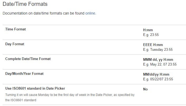

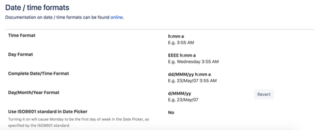

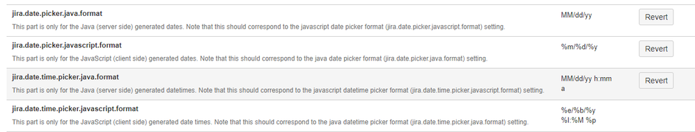

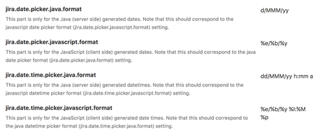

- A screenshot of your Look and feel date/time formats (JIRA Settings > System > Look and Feel):
- A Screenshot of your date picker format (JIRA Settings > System > General Configuration > Advanced Search):
Additionally, check the screenshots I provided and confirm if there any different setting that might be causing the issue.

Here is the Time settings:
The number of working hours per day is 8.
The number of working days per week is 5.
Time estimates will be displayed in the following format: pretty (e.g. 4 days, 4 hours, 30 minutes)
The current default unit for time tracking is minute.
Copying of comments to work description is currently enabled.
For the users you wish to be able to log work on issues, ensure that they have the Work On Issues permission in the relevant permission scheme.

The look the same so I will open a ttk
Robert G. Nadon
May 6, 2019
Upon second look the middle one is slightly different as I had a request for the customer to change the default to MMM for Complete Time/Date format.  But that shouldn't change it to minutes one would assume.

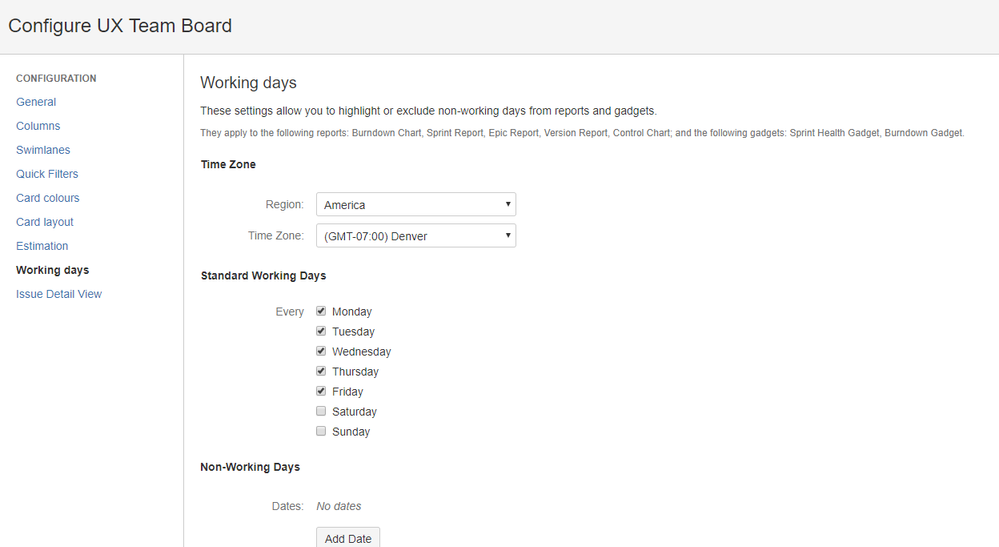

1 - Navigate to your board > Board settings > Working days > Provide us with a screenshot of this page and also try to change one of the days and them change it back to what it was, checking if it has fixed the problem

I did mention this community post and provided a link in the TTK.  Here is the working day config for the board.  I only see that when starting a sprint so I will try to setup a dummy environment and see if I can reproduce.

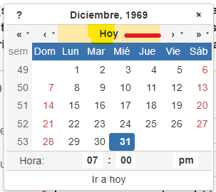

Another case that I saw was when I selected in calendar today (HOY), it set an incorrect date value by default

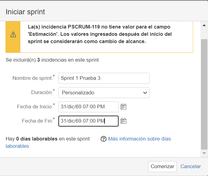

The value that sets me is: 31/Dec/69 07:00 PM being today 21/02/2022 hours 11:17
If I put the start date and end date with the same day and click on the start button, the sprint is created without problem.
Start date
12/30/69 7:00 PM
projected completion date
31/Dec/69 7:00 PMsprint.png
