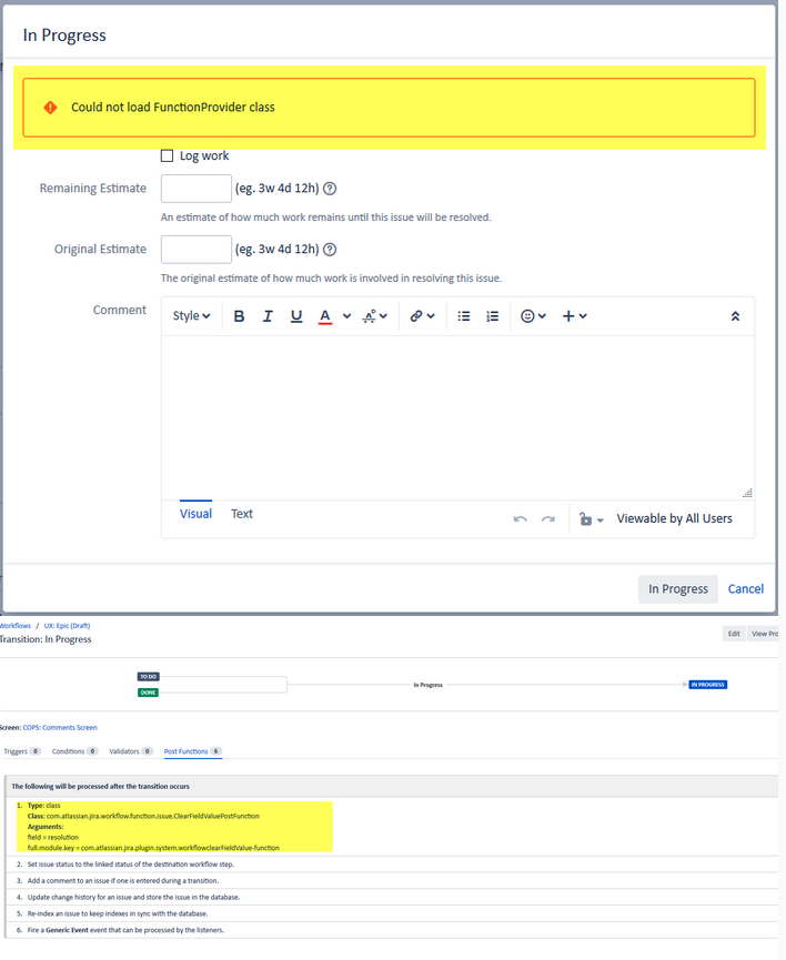

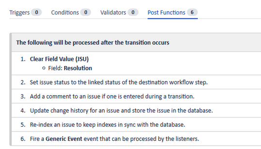

What happened was, during migration, the JSU (jira Suite utilities) rewrote some of the transitions to have post-functions in an inaccurate way.  I got an error message "Could not load FunctionProvider class" when trying to make the state change, where there was a post-function to clear the Resolution field.  I had to edit every transition in every workflow where this error occurred (yes, that meant testing every transition in our workflows schemes!) to rewrite the post-function.  It looks like the post-function code should work, but when I re-wrote it, it was the simple, clear form. (second picture).
Here is the error and its cause:
Here is the corrected form:image.png
This may not be your specific case.  But if you get prevented from state transitions, look into the conditions and post-functions, and compare what you see to transitions which do work.
