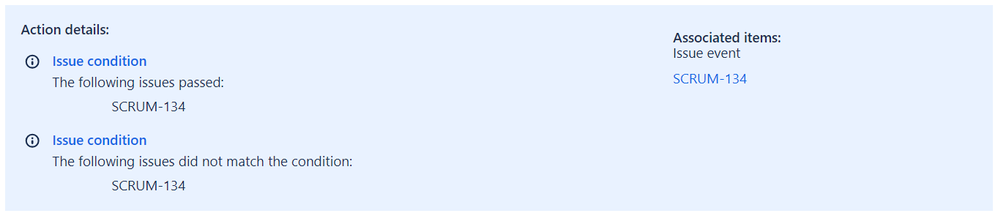

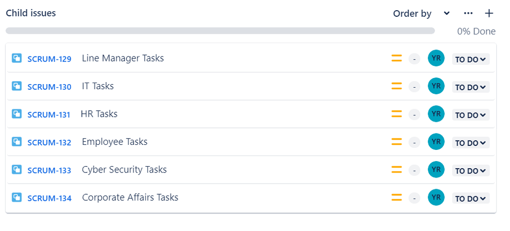

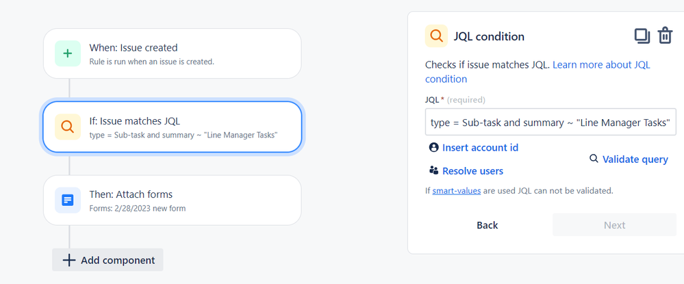

I have created an automation when an issue is created, it will automatically create 6 subtasks, this works perfectly. But then I have created another automation, when the issue is created, and if certain conditions are met (as shown below), it will attach a form to a specific subtask. When I checked, it actually worked, but when I checked the audit log, it says 'no actions performed'. And it's checking on a wrong subtask (which is 'SCRM-134'), while it should check on 'SCRUM-129'. What could be the problem here?

Instead of 2 conditions, can you try using "JQL condition"
Example JQL: type = Sub-task and summary ~ "Line Manager Tasks"

I have tried this using JQL condition, it still doesn't work
