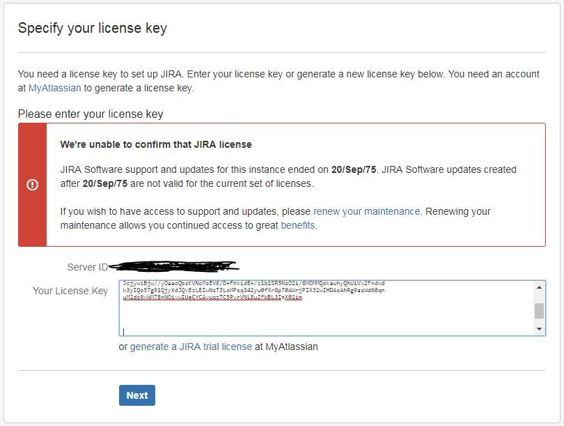

I have just paid for the jira software on Sep 12, 2017 but I have got the error "We're unable to confirm that JIRA license" which the istance ended on 20/Sep/75  and I cannot complete the installation.
JIRA Software support and updates for this instance ended on 20/Sep/75. JIRA Software updates created after 20/Sep/75 are not valid for the current set of licenses.

I took a look at your account in our internal system.  I cannot explain why your JIRA instance appears to be generating this erroneous date so far.   I was able to validate your the license key attached to your account on https://my.atlassian.com for this JIRA starter license.  That license key is valid and should have a maintenance expiration date of 12/Sep/18.   I don't understand how your system is generating this other date.
I would like to know more about the license key as you have entered it here.  For example, did you just copy and paste this from https://my.atlassian.com ?  The concern I have is if the copy was incomplete, or the key has been altered, or there are additional characters being included such as whitespaces, carriage returns, etc that this license key could be falsely reporting the incorrect date.
The other aspect I would like to know more about is, what date/time does the system clock say on the server where you are installing JIRA?   Is this using the Geogorian calendar?   Or is the server JIRA is running on using a different calendar such as a Buddhist, Hebrew, Persian, Chinese, etc?

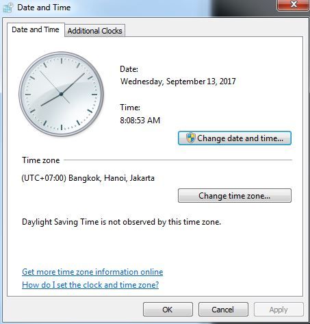

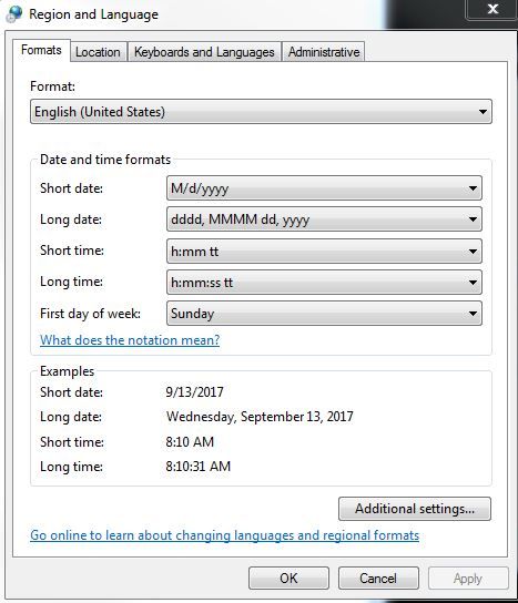

The data/time format is English (United State) and the time zone is UTC+7 Bangkok.
I have tried to set Location from Thailand to United States and system locate from Thailand to Enligh (United States) but I have still got the error on Chrome, IE, and Firefox.
