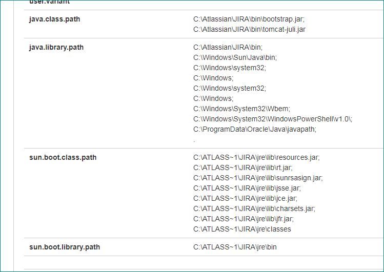

for jira software 7.6.3 I am testing with Windowsserver 2012 and SQL2014,  I installed java on windows server , then install JIRA.
refer to the attached screenshot,  I wonder which java JIRA is using as today I just enable JMX monitoring, we did have some garbage collection issues. java settings in jiratest 763 instance.JPG
Timothy
January 18, 2018
Jira ships with a JRE in it and it looks like you're using it. Scroll up and you'll find a label called Java Version.

C:\Atlassian\JIRA\jre\bin   is the one came with jira installation
c:\java\bin   is the one I installed
should I just go with C:\Atlassian\JIRA\jre\bin   as it is actually shown in system information 1.8.0.102  ?
but how to upgrade this java version inside jira ?
is java upgrade coming with jira software version upgrade ?
