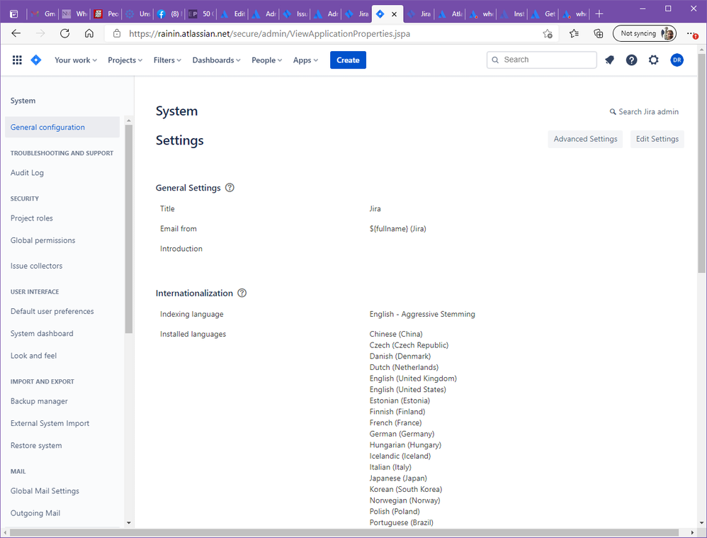

I see a settings icon, and then down to 'System', but there is no System Info link like what the instructions say.

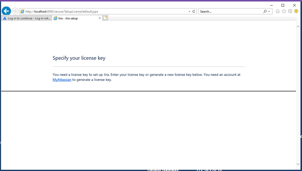

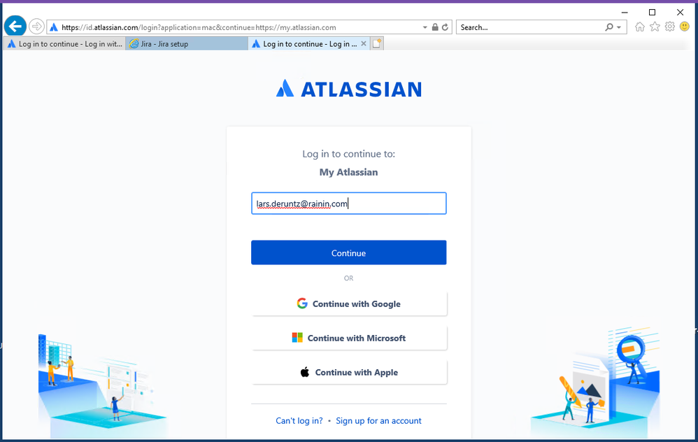

Then I get bumped into this sort of loop.  I can see redirects and eventually I am at the login page again.jiraSetup3.png

So maybe something wrong with my account?

This is the gotcha part:

Actually, the gotcha part is the screenshot of the licence set-up screen tells us there's something wrong - Jira is working, but your browser is not rendering the pages correctly.  The licence box should be a box, not a line, and you're missing the display of half of the things on that screen, including the server id.
It looks like you're using a broken browser to do the set up, could you try switching to another browser?  A recent Chrome or Firefox would be best.

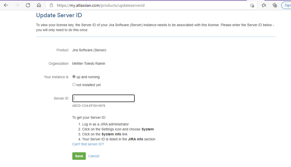

I just figured that out.  I installed Microsoft Edge because I saw some other issues with rendering and thought that it could be relevent... and when I opened the Access Jira" page in Edge, the SERVER ID was right there.... I copied and plugged that in to the accounts view licensne,a dn then a big hash was generated that I put back in the install process.

I notice your earlier screenshot is of Admin -> General settings (and of a Cloud system, not a Server install) - that's the right area, you'll find system information is available in the left hand menu on a server installation.

I went into the cloud version, because I cannot find any other way to access anything.
