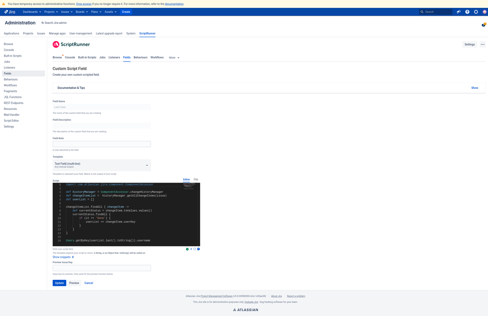

Please share a screenshot of your Scripted Field configuration so I can better understand your configuration.
I am requesting this because I am using the ScriptRunner configuration below and it is working just fine for me.
Below is a test screenshot for your reference:-
Once the issue transitions to done, the last user is displayed on the Scripted Field.

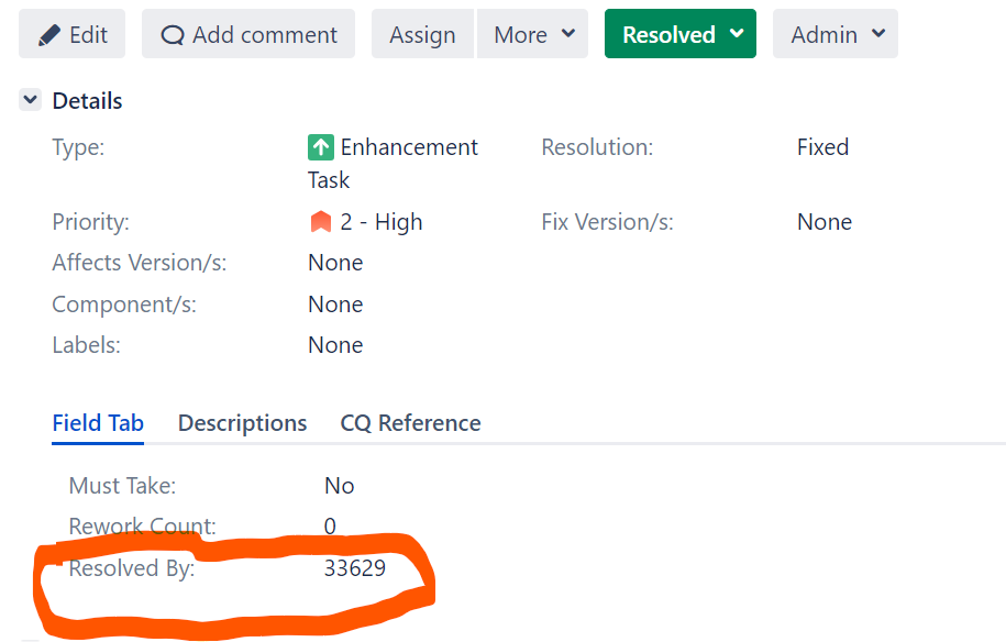

Thank you so much its' worked, I have updated as above mentioned in above screen shot, but it has to show 'Resolved by' field as user id for exmaple if my user id is vbalaji then it has to show 'Resolved By vbalaji'
However, after updating above script we are seeing resolved by as 33629 instead of user id.
Ram Kumar Aravindakshan _Adaptavist_
July 18, 2023
Hi @Velkuri Balaji
The number that it displays is the user id.
Are you trying to display the user's username? If yes, change it to:-
Users.getByKey(userList.last().toString()).username

Thanks in advance,
Balaji

Hi @Ram Kumar Aravindakshan _Adaptavist_
After updating above script, we are getting below error, it seems like if any issue doesn't have "resolved by" status it's throwing an error.
2023-07-19T01:08:32,985 ERROR [customfield.GroovyCustomField]: ************************************************************ 2023-07-19T01:08:32,985 ERROR [customfield.GroovyCustomField]: Script field failed on issue: JIRA-193, field: Resolved By java.util.NoSuchElementException: Cannot access last() element from an empty List at Script17.run(Script17.groovy:16) ~[?:?]
Could you please help on above issue.
Regards,
Balaji

Velkuri Balaji
July 19, 2023
Hi @Lukasz Grobelny
'Resolved By' is a field and the script we are updating to resolved by field only,
Actually, In our case we have resolved status for some workflows, and it's associated with few projects and rest projects workflow doesn't have resolved status.
Therefore, we would like to see the resolved by field if status has changed to resolved now that is working fine, however when we open any issue which doesn't have resolved status we are getting above error.
I hope you understand the requirement.

Lukasz Grobelny
July 19, 2023
Oh, not an array, you are getting an empty list, sorry. So no value is being stored.
