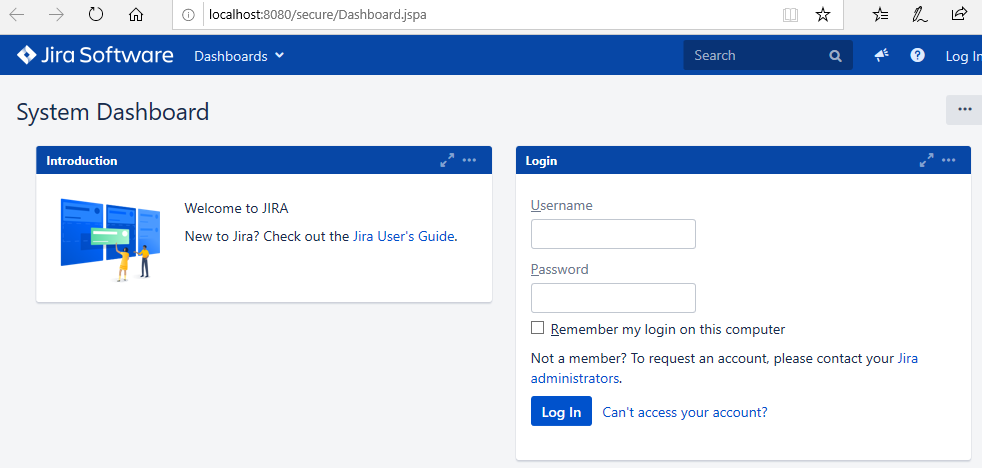

I uninstalled Jira Core and downloaded it again. following the steps in the document, I started installation and selected the default Express configuration. During installation, there is no were to setup admin account. Jira completes the installation. Clicked the "Next "button and it finished the configuration. Then it informs me that Jira is ready to run in my default browser. I click "Finish" button and the browser window displays Login screen as shown below.
I understand that Admin account needs to be created somehow, but how do I create the Admin Account?

Hello @Hassan Arif
Every Atlassian Application installation comes with a Admin account set up process. I wonder how that step is missing out for you. Please recheck on the installation procedure and try again, because without admin account creation there is no way you can login to the application.

Deleting the dbconfig.xml file from the Jira Home directory and re-executing the Jira Core installation solved the issue of establishing the local Jira admin account.
