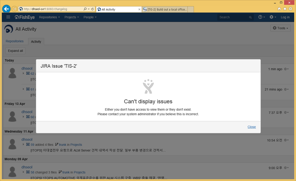

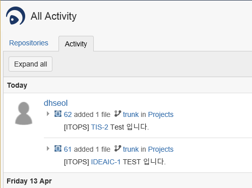

I entered the generated Issue Key(TIS-2, IDEAIC-1) in the visualsvn commit message. Then, when I click on the issue key in FishEye, the following error occurs.
How do I fix it?
Waiting for yours help.

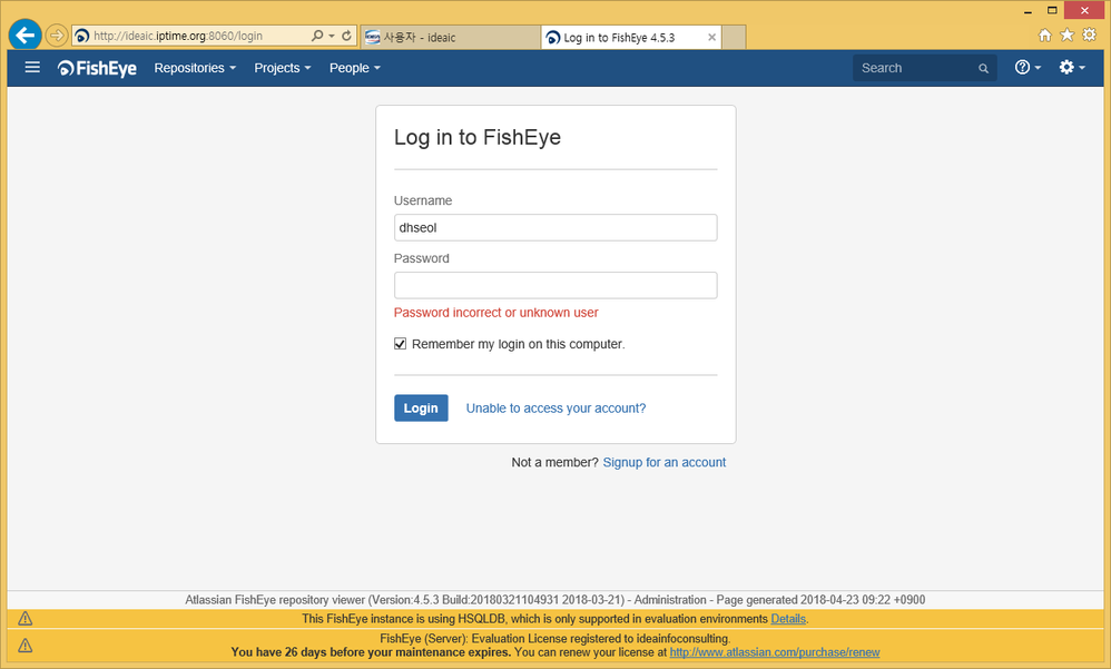

The FishEye dhseol account is an account created on FishEye through FishEye and JIRA integration. If you try to log in to FishEye using dhseol account, the error will occur.
And FishEye is using HSQLDB rather than MySQL.
Is not it the problem that JIRA uses MySQL and FishEye uses HSQLDB?
However, I do not know why JIRA has access to VisualSVN via FishEye.

Thomas Deiler
April 23, 2018
Dear @alex seol,
this sounds like the account "dhseol" does not exist in Jira, just locally on Fisheye side. Jira tries to use this account when connecting to Jira - that will fail.
To avoid troubles like this, I recommend to use Jira as authentication server for Fisheye. Then you have to manage only one user directory and not two on Jira and Fisheye side.

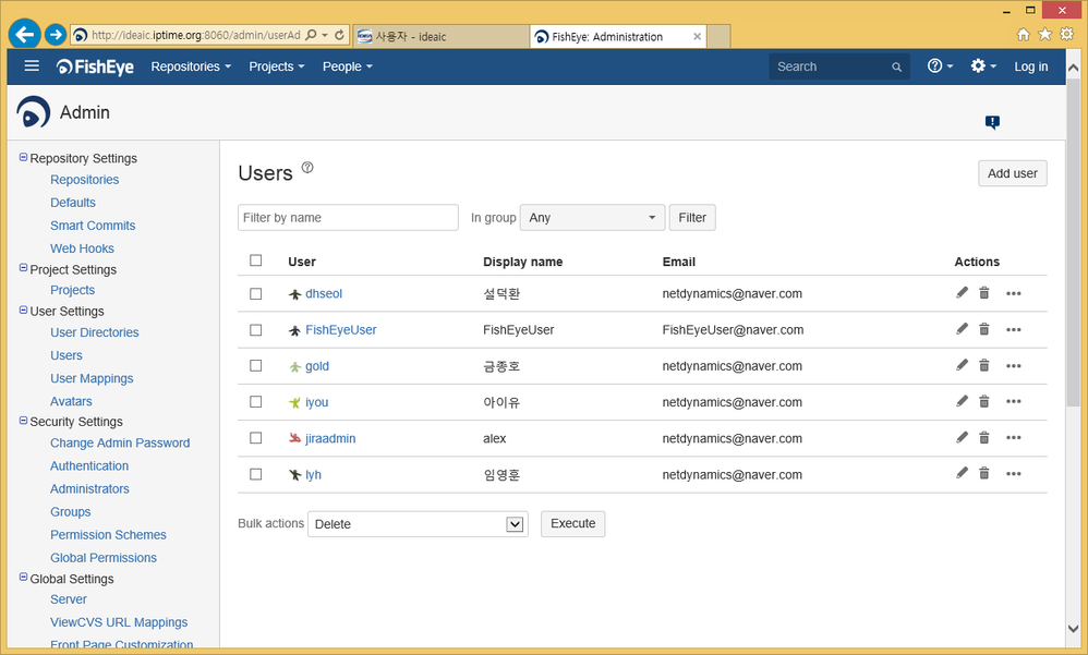

There is a dhseol account on the FishEye side(see below). However, FishEye does not log in to the dhseol account.
In this case, what should I do first?

Thomas Deiler
April 26, 2018
Dear @alex seol,
first you need to login into Fisheye. Not with an admin account ideally. Then, when clicking on the links to Jira, you get redirected and should be able to login in Jira, too.
And note, that the login on Jira requires the permissions "browse project" and "development tools" for the project TIS.
It is also possible, that Jira takes the same account you used for Fisheye to view the issue - but this account is not the same - so you get a permission error like on top of this question.
Best you configure Fisheye as I have already described.
