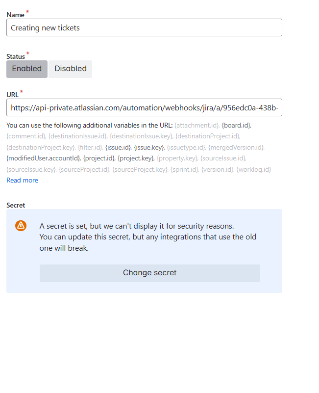

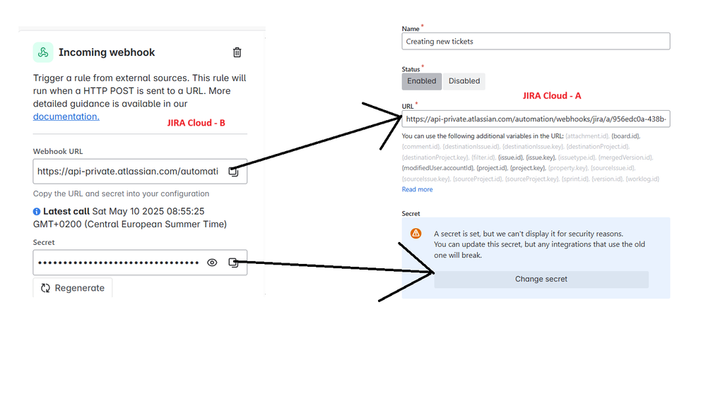

I am just testing webhooks between 2 instances of JIRA Cloud - jirasource.atlassian.net and jiradestination.atlassian.net. On JIRA Destination, the webhook url given to me is "https://api-private.atlassian.com/automation/webhooks/jira/a/95xxxx-xxxx" and a secret key which I am passing both to jirasource webhook URL and Secret.
When I create a item in jirasource, nothing happens in jiradestination.
I have tested with curl and it works. So I am assuming the problem is in the way I have configured the jirasource... But the way I did it it just copy/paste of webhook url and secret into the webhook.
It does not work.. I cannot receive a webhook triggered from JIRA it seems.

Thanks Piyush for your replay. No issue with curl commands. In the JIRA webhook, I copied the url I am given by my automation starting with https://api-private.atlassian.com/automation/webhooks/jira/a/ and I add the secret key. See picture:whk.png

Thanks Michael for your reply: I have created a webhook from JIRA but how do I add this X-Automation-Webhook-Token header?  I can create a ticket using a script but that is outisde JIRA. Curl commands work. What does not work is creating the webhook from JIRA to trigger a incoming webhook on the "destination" JIRA (knowing that everything works with webhooksite.com) - Below how I am creating my webhook in JIRA. whk.png
Christophe Le Coent ELCA
May 11, 2025
with a script, url and secret, it works. From JIRA: KO.

@Christophe Le Coent ELCA I made it work
Read here: https://support.atlassian.com/cloud-automation/docs/configure-the-incoming-webhook-trigger-in-atlassian-automation/
Starting with: "If your application does not support custom HTTP headers, you can instead insert a slash at the end of the URL and add the secret after this."

Yes I did read it: my application is... JIRA. This is between 2 JIRA clouds. so if JIRA does not support custom HTTP headers, what do I do in step 7 ?
Bartosz Wozniak
May 23, 2025
I got the same. I'm triggering automation webhook from Jira workflow. I adjusted internal webhook using URL/SECRET?issue=${issue.key} and it started to work.

System settings -> Webhooks -> URL
Then I'm using this webhook in workflow's action "Trigger webhook". But in general, you can use this url schema everywhere you can't set url headers (for setting the secret). Then just pass secret as a part of webhook's url.

Do you mean I should add secret and issue to the url such as:
https://api-private.atlassian.com/automation/webhooks/jira/a/956edc0a-438b-url-url-url-24c3249f41d/0196b57e-b07d-7cd8-896c-2c6f63dcd819/c799be80-secretkey-8b1bdd2a5?issue=${issue.key}
Bartosz Wozniak
May 26, 2025
I don't know how and where you are triggering webhook. In my case, the difference between new and old implementation was to update url address and add /secretKey at the end. I user ?issue=${issue.key} already, so I didn't have to add it.
If you are not using ?issue you don;t have to add it.
Simply, just test new URL with the secret with Postman using simple POST request.
