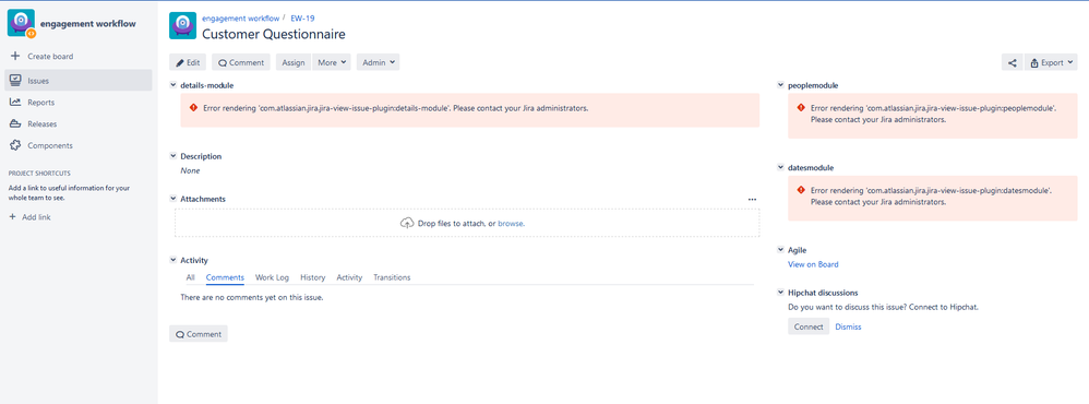

web ui fails to render at issue view page
CyberSage
January 13, 2020
At issue view page, see errors.
I tried to restart Jira container after google. no luck.
Error rendering 'com.atlassian.jira.jira-view-issue-plugin:details-module'. Please contact your Jira administrators.
Error rendering 'com.atlassian.jira.jira-view-issue-plugin:peoplemodule'. Please contact your Jira administrators.

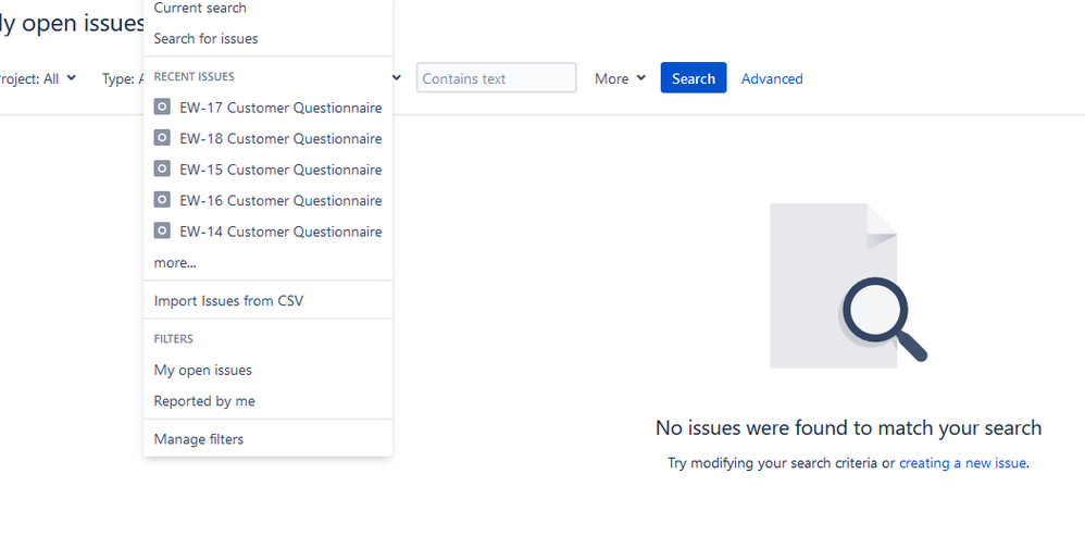

The docker containers are running fine. The Jira has valid license and the UI pages (admin, issue creation) are responding to requests .  see the screen inserted for the error.

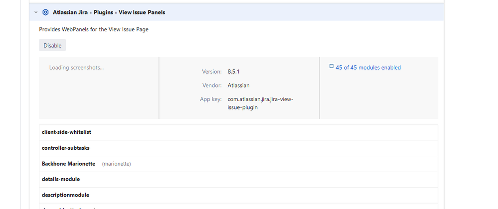

  are there Jira docs on how to check Macros? here is the screenshot of the details module config. it can not render but shows enabled in the config.

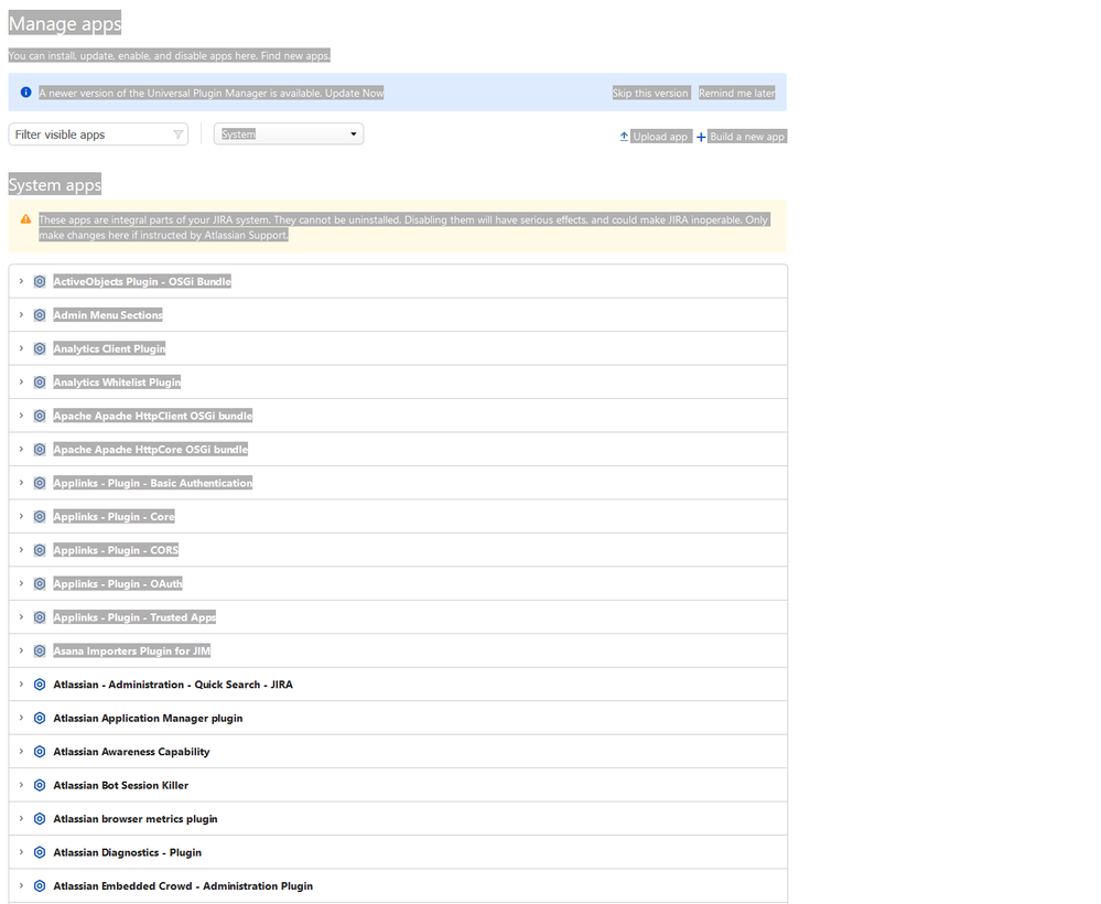

@CyberSage Please be really careful when you are checking the system plugins.
Click on the arrow pointing to the right by the plugin name it will show you how many macros you have in total if it says for example 20 of 23 then you know that 3 of them are disabled.

I checked every add-on with "issue" in the name and do not find any macro which are disabled.
what else can we check?
