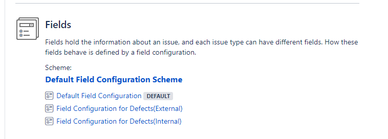

I want to make the root cause and developer resolution a required field on one project, but not a required field on any other project which using the same field configuration. can anyone please help me as I am new to Jira and it is an urgent requirement. thanks in advance please show me step by step guide

You would need to create an additional Field Configuration for that project. You can copy the existing Field Configuration, make the modification, then attach the new FC to the appropriate project.
You will probably need to create a new Field Configuration Scheme as well.

Hi @John Funk  If i copy field configuration scheme than it will copy all the field below field also right
John Funk
June 9, 2020
Yes, it should
