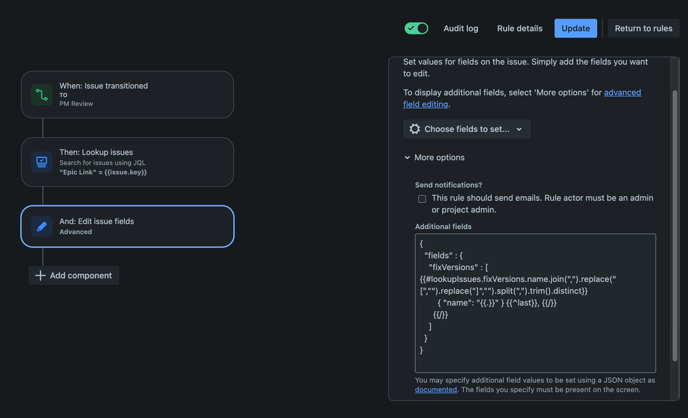

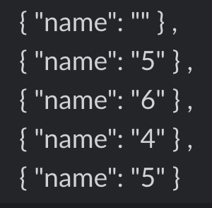

Amir Shmulevich
September 22, 2024
error message - "Version name '' is not valid (fixVersions)"
for some reason the first value is empty
Bill Sheboy
September 22, 2024
Please post an image of your current, complete rule and an image of the audit log details.  Those may reveal a problem with the results from the Lookup Issues action.
Amir Shmulevich
September 22, 2024
Bill Sheboy
September 22, 2024
One or more of the child issues in your Epic has no Fix Versions assigned.  If that was expected, the fix to handle the case is to change the JQL for the lookup to exclude them:
"Epic Link" = {{issue.key}} AND fixVersion IS NOT EMPTY
If it is possible none of the issues in the Epic have values, I recommend adding a condition after the Lookup Issues action so the rule will not proceed.

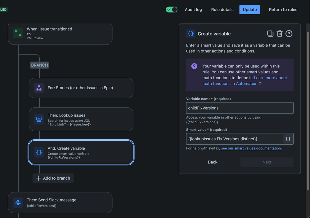

Amir Shmulevich
September 15, 2024
thanks. I followed your instructions and  created the automation.
but when I sent the data in the {{childFixVersions}} I am getting the child issue keys and not the fix versions.
did I miss anything?
Manoj Kumar Gangwar
September 15, 2024
It sounds like the {{childFixVersions}} variable is capturing the child issue keys instead of the Fix Versions. This likely happened because lookupIssues by default returns the full set of issues, and if you're using the smart value incorrectly, it may be referencing the issue keys.
To fix this and properly extract the Fix Versions from the child issues, you can refine the smart value syntax to target the specific field (Fix Versions). Here's how you can adjust it:
In the Create Variable Action: The variable childFixVersions should reference the Fix Versions field of the child issues. Fix Versions is a multi-select field, so to capture it properly from all child issues, modify the smart value like this:
{{#lookupIssues}}{{Fix Versions.name}},{{/}}
This will iterate over each issue in lookupIssues and extract the Fix Versions by name.
If you want to remove any duplicates, you can apply the distinct function:
{{lookupIssues.Fix Versions.name.distinct}}
This will gather only the unique Fix Versions from all child issues.
Amir Shmulevich
September 15, 2024
when I changed the lookup value from "Epic Link" = {{issue.key}}  to "Epic Link" = {{issue.parent.epic.summary}} - I started getting the fixVersion in my variable.
the value I see for the  {{childFixVersions}} is "5, 6,5, 6,3, 4,"
but it is still not getting updated in the Epic fixVersions field. and the Epic fixVersions field is being deleted instead of updated.
Manoj Kumar Gangwar
September 15, 2024
It seems like you're almost there! You’re now correctly capturing the Fix Versions from the child issues, but the formatting of the {{childFixVersions}} value is causing the Epic’s Fix Versions field to be deleted instead of updated. The issue lies in how the values are being processed and fed into the Fix Versions field.
You can fix this by:
Removing duplicates.
Cleaning up the comma-separated list.
Ensuring the format matches what Jira expects for multi-select fields.
Here's the Correct Approach:
1. Use the distinct and join Smart Value Functions
To ensure that the Fix Versions list is unique and formatted correctly, update the smart value for childFixVersions to use both distinct and join functions:
{{lookupIssues.Fix Versions.name.distinct.join(",")}}
This will:
Remove duplicates using distinct.
Combine the Fix Versions into a comma-separated list with no extra commas or spaces using join(",").
Bill Sheboy
September 15, 2024
Hi...
Creating a variable inside of a branch which could be on more than one thing will not work for this scenario.  Such branches run in parallel and asynchronously, and thus the variable will repeatedly go out of scope.  After the branch, the variable is not available.
Like Hans Polder likes this
PREMIUM
