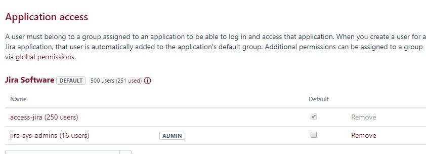

deirdrerodgers
August 26, 2019
Hi @Amith Mathur {Appfire}
thanks for the reply.
There is only one AD configured and user derodgers is part of it. I also checked the application access and derodgers is a  member of the application access group
Other users in our north american region are able to log-in successfully against the same AD so its very strange that any EMEA users are failing to authenticate.app access.jpguser.pngdir.png

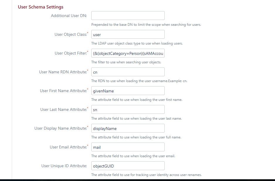

deirdrerodgers
August 26, 2019
Hi Amith,
yes it is my user name
2019-08-26 11:57:29,327 http-nio-8080-exec-15 anonymous 717x299x1 1pb8y75 x.x.x.x /login.jsp login : 'derodgers' tried to login but they do not have USE permission or weren't found. Deleting remember me cookie.
I have checked the directory configuration and compared the settings from before and after and they have not changedad.jpgad2.png
