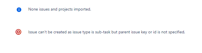

akshaybhange
August 12, 2024
got an error,
"None issues and projects imported.
Issue can't be created as issue type is sub-task but parent issue key or id is not specified"
Sample CSV : Screenshot 2024-08-12 182035.png
Issue key, Summary, Issue Type, custom field
KAN-2, SubtaskSummary, Subtask, customValue
John Funk
August 12, 2024
Oh, sorry, yes you do not need the Issue Type field either since these are just updates and not creates.

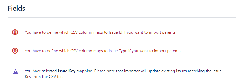

akshaybhange
August 12, 2024
Got 2 issues here. if I add parent id (for eg. 10000) it is asking for issueID & Issue Type.
If I provide both of these then it'll skip the issues.
Feels like a loop :(
John Funk
August 12, 2024
The Parent should be a Key like ABC=123, not the ID.
Can you post a screenshot of the first row of your CSV, along with the header row?
Also, can you post a screenshot of the mappings in the import tool?

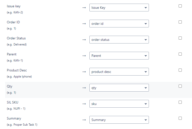

akshaybhange
August 13, 2024
CSV:
Issue key,Parent,Summary,Order ID,SIL SKU,Qty,Product Desc,Order Status,Courier,AWB Number,Dispatch Date,Delivered to,Delivery date
KAN-2,KAN-1,Proper Sub Task 1,1,NUPI - 1,1,Apple Iphone,Delivered,Bluedart,12345678,15-Jul-24,Person 1,18-Jul-24
Mappings: I've not included some of the custom fields which are not relevant:

John Funk
August 14, 2024
I don't know. I am seeing a lot of questions in Community the last few days about CSV import problems. I suggest you open a support ticket with Atlassian to see what they say.
