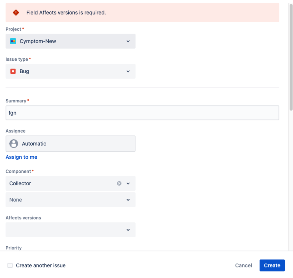

hello,
i'm trying to create an issue via jira's api, and this error returns:
"errorMessages": [
"Field Affects versions is required."
"errors": {}
but when I request from the jira api all the fields of that issue type, it says that the field 'Affects versions' is not required: (required: false)
"versions": {
"required": false,
"schema": {
"type": "array",
"items": "version",
"system": "versions"
"name": "Affects versions",
"key": "versions",
"hasDefaultValue": false,
"operations": [
"set",
"add",
"remove"
also, when i'm trying to create the same issue in the jira ui, i'm getting the same error. (and you can see that this field is not required, like the field 'components'
how am i supposed to know that this field is required when i'm creating an issue via jiras api, if even the api says that its not?
thanks!

It looks like you are using a validator to make the field required, rather than doing it in the field configuration (if you did it in there, the * that indicates a field is mandatory would appear on the create screen)
You'll need to adjust your REST call such that it fills in a valid version, or remove the validator from the create transition.

I am sorry, I was focussing more on the error, and your comment just made me realise I'm not talking about your actual question!  I should have seen that earlier.
The problem here is how your admins have made the field mandatory.  It's not their fault, nor what you are doing, it's the way Jira works.
Jira can tell you when a field is mandatory because the field configuration says the field is, but it can not understand all the things you might be doing in a validator.   The validator could be doing almost anything (especially when you've got an automation or scripting app).
Jira can see validators, but it can not understand them for us.  You and I can easily read a bit of (validator) code and say "oh, well that makes field X mandatory", but Turing machines don't understand it.
TLDR: There is no way Jira can tell you what the impact of your validators are over the REST API.  Until you try something that fails validation.
