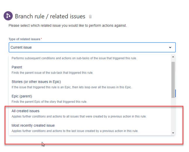

Regarding your rule structure, branches which could be on more than one thing are executed in parallel and asynchronously, with no guarantee of when the branch will complete, up until the last step of the rule.  For your rule, this means:
  • the first branch to clone the issues will definitely not complete before your later branch to attempt to transition the issues processes
  • and, the value of "all created issues" used in the branch will not mean what you think it means; instead it will be at a moment in time and not likely contain all of the created issues

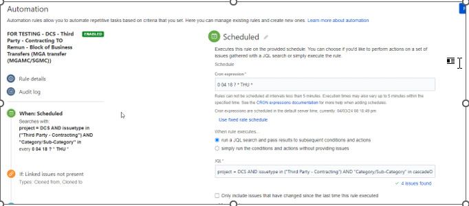

Automation Query
project = DCS AND issuetype in ("Third Party - Contracting") AND "Category/Sub-Category" in cascadeOption("Contracting Third Party - Change", "MGA transfer (MGAMC/SGMC)") AND State = "Transfer ready" AND updated >= -1d AND updated <= 1d

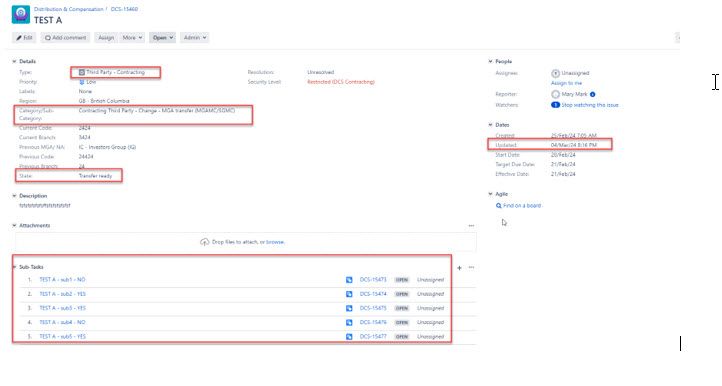

Using this ticket as example: TEST A meets the criteria of the filter

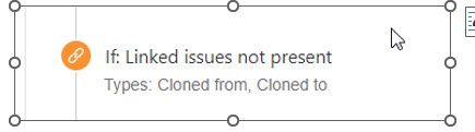

The automation rule will check to ensure that there are no existing clones. IF there are any clones existing then there will be no actions performed on ticket.

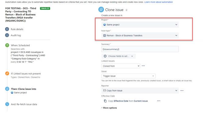

The clone parent ticket will be created in the same project and issue type will be: Remun – Block of Business Transfers

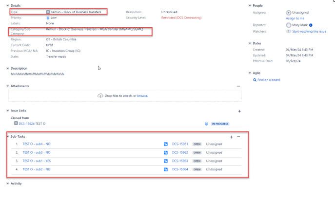

By running the rule, the ticket got updated:

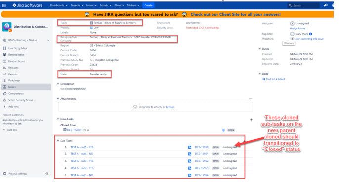

DCS-15941 is the new cloned parent

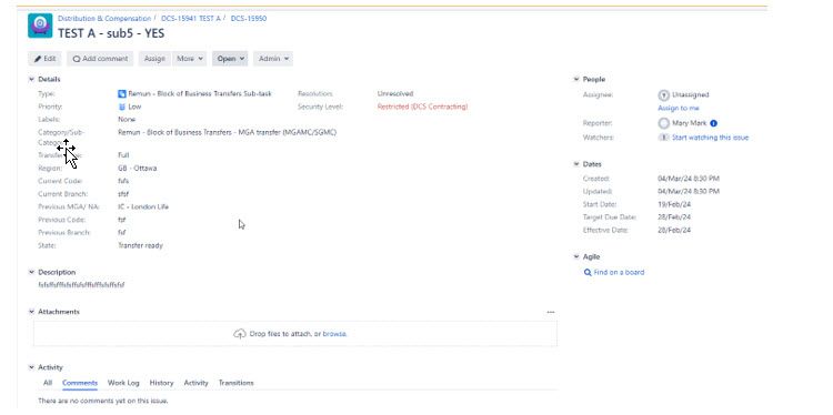

Source issue type is cloned to target issue type properly and category/sub-category is updated properly. Everything seem to clone over successfully along with sub-tasks. The only thing is that the new cloned sub-tasks should transitioned to “Closed” status
Here is the new sub-task clone in the issue view screen. Everything is correct however the status should show as “Closed”
As you can see here, if I go under the status: “Closed” is an available transition BUT why didn’t it go to “Closed”

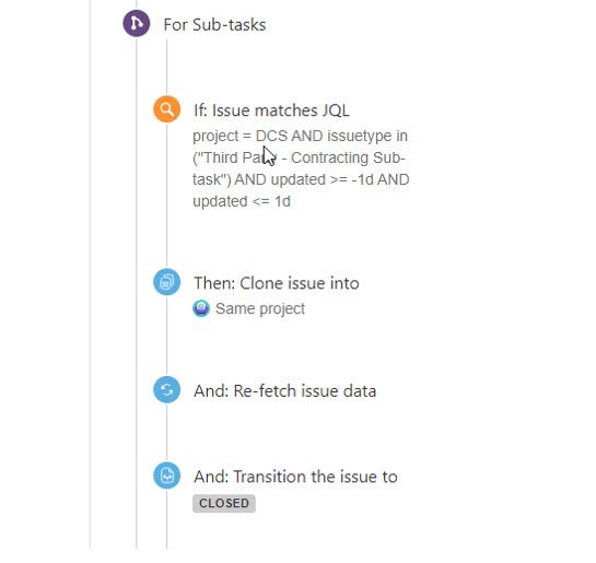

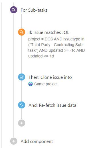

For the subtasks, if written this way:
Then the original sub-tasks are transitioned:
BUT I do not want this. I want the new sub-tasks clones to be transitioned to “Closed” but it is not.
Basically I am trying to figure out how to handle the new subtasks clones to transition to the status “Closed” once this is executed
I tried using another branch rule and using the following:
BUT That didn’t work.

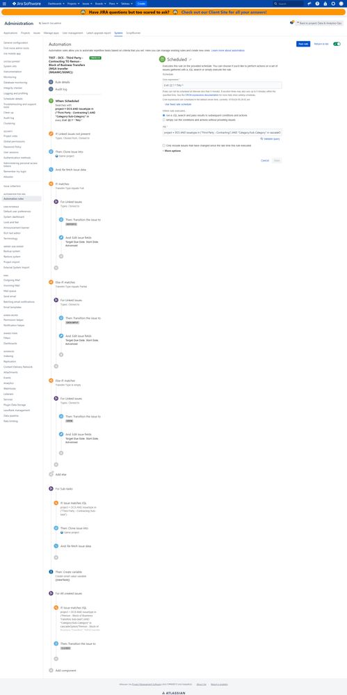

Here is the entire rule where I'm trying to use the "Create variable" but I'm having trouble.
Please kindly advise.
