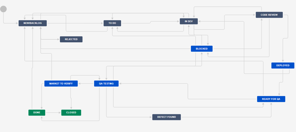

Suma Pralhad Kustagi
December 3, 2020
This is the snippet of the workflow.
I do not see any thing in History of tickets regarding the Resolution.WF.PNG

Can you give us a snippet of the history too please?  It will have to be one that resolved when you thought it shouldn't.
